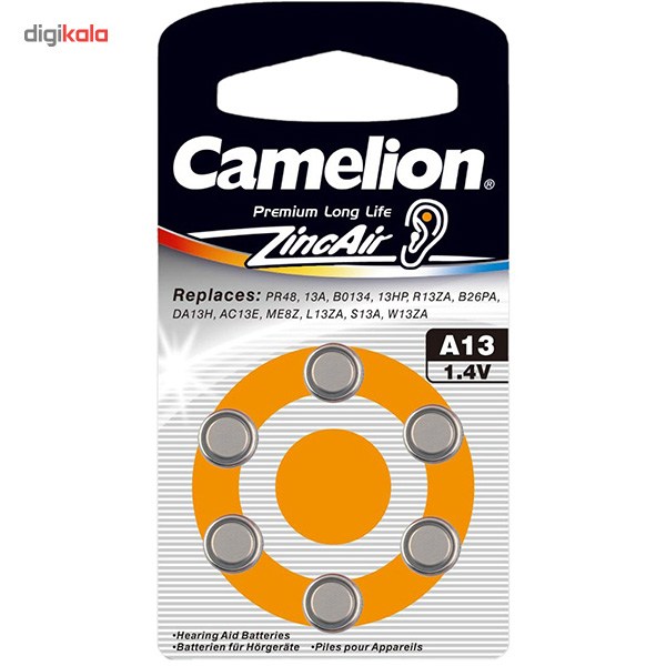

... OM-1 (which is a pain to find a suitable battery for).
lost track of how many times I've read this over the years, even though zinc-air equivalents have been around for at least as long as the mercury batteries have been banned, if not longer. Just hunt down some 1.4V ZA675 hearing aid batteries (the extra 5mV makes next to no difference). I've been using them for nearly 15 years.
Will these do?

Those are the type of batteries, but I don't think they are the correct size.
The original mercury batteries were quite large - size 625. Most approach the issue of replacing them by inserting a current battery that is somewhat smaller - 675 size - and then taking steps to ensure proper fit.
The 675 batteries can sometimes be used with a little bit of foil to improve the fit, but they are easiest to use if you buy an inexpensive adapter that improves the physical fit of the battery.
You keep and re-use the adapter, and buy the easily replaceable hearing aid batteries at any place that sells them.
The adapters are available from a number of sources. I bought mine from Jon Goodman, who is best known as being an excellent source for replacement light seal kits, but sells the adapters as well.
There is a yahoo email address for him here: http://www.kyphoto.com/classics/sealreplacement.html
Jon also posts here on APUG/PHOTRIO.

Yep :smile: MattKing is correct they are slightly smaller than the original, you can buy an adaptor to improve the fit, but I've used them successfully in two OM-1's and a 35RC without adaptor for near enough all this century and never had an issue. The Weincell is also available, but they are over priced and other than being the correct size they offer little to no additional benefit IMO.

A #9 o-ring also works great as a spacer to allow use of the 675 zinc air battery in the OM-1 and many other older cameras that used the 625 battery. As long as the camera battery contacts are on the top and bottom (and not side) of the battery. I find them in the plumbing department of home improvement and hardware stores.
