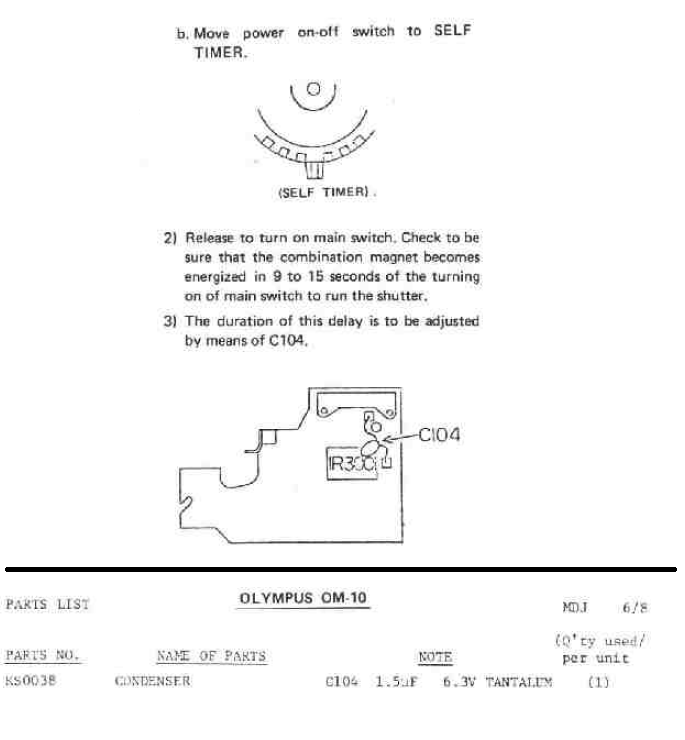

I have an OM-10 with a weird self timer issue.
It is the exact same problem that "Anon Ymous" describe in his thread. https://www.photrio.com/forum/threads/om10-erratic-self-timer.137237/
The self timer start, but usually run for more than 20 seconds. Sometime, if the camera face a bright light, the camera release the shutter after only 3 or 4 sec.
I have search in the repair manual and think it's the capacitor call C-104.
If someone know that for sure it will help me to be sure before disassembling the whole thing :wink:
Thank you :smile:
