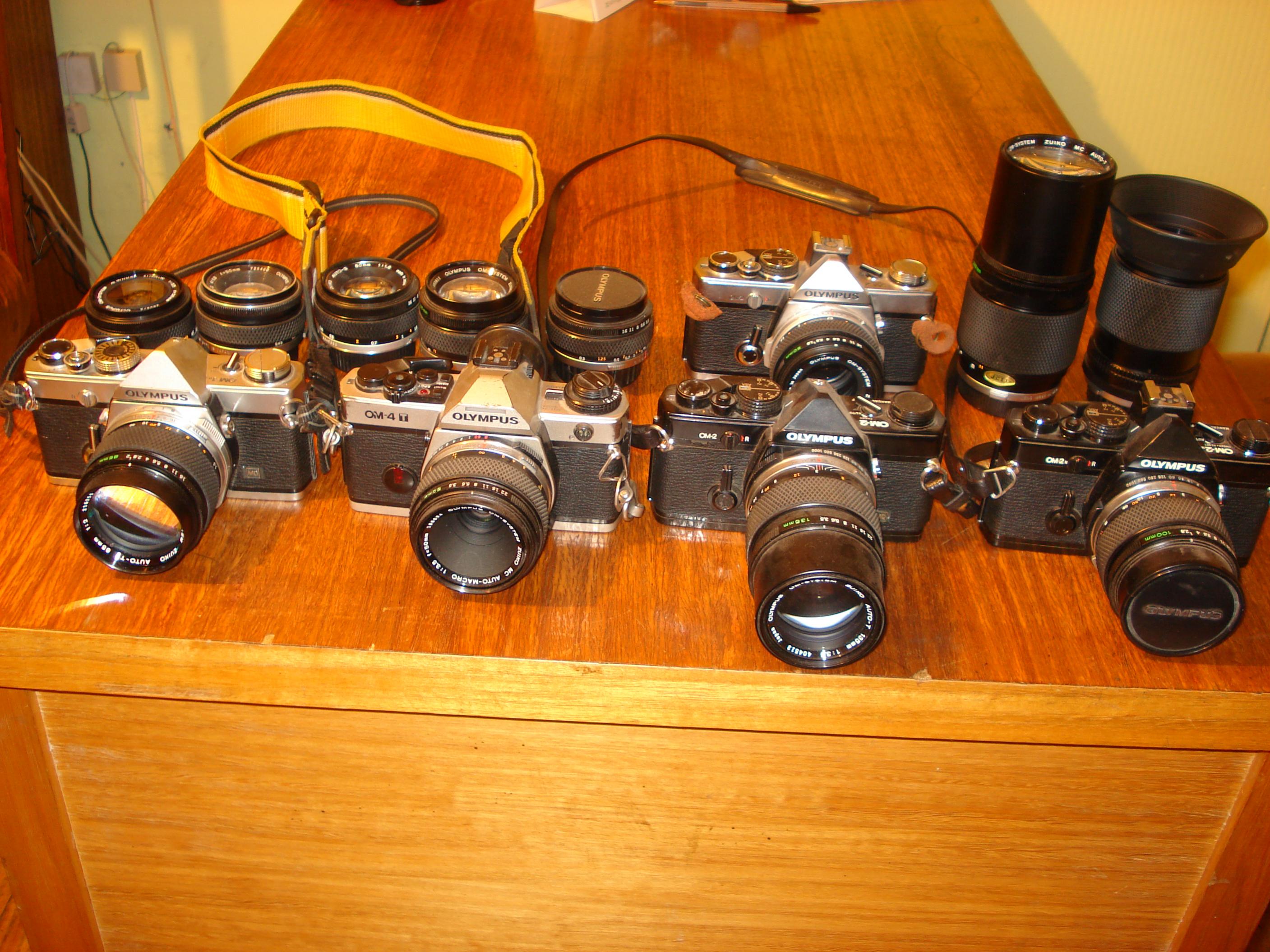

I love mine:
OM1
What a question?
There is no way around a OM1 ... mine survided 2yrs east africa, adjust voltage divider to 1.5v and use SR44 for lightmeter.
Never go out without a 2/85 or a 2.8/28 - you may miss life worth living ;o)
