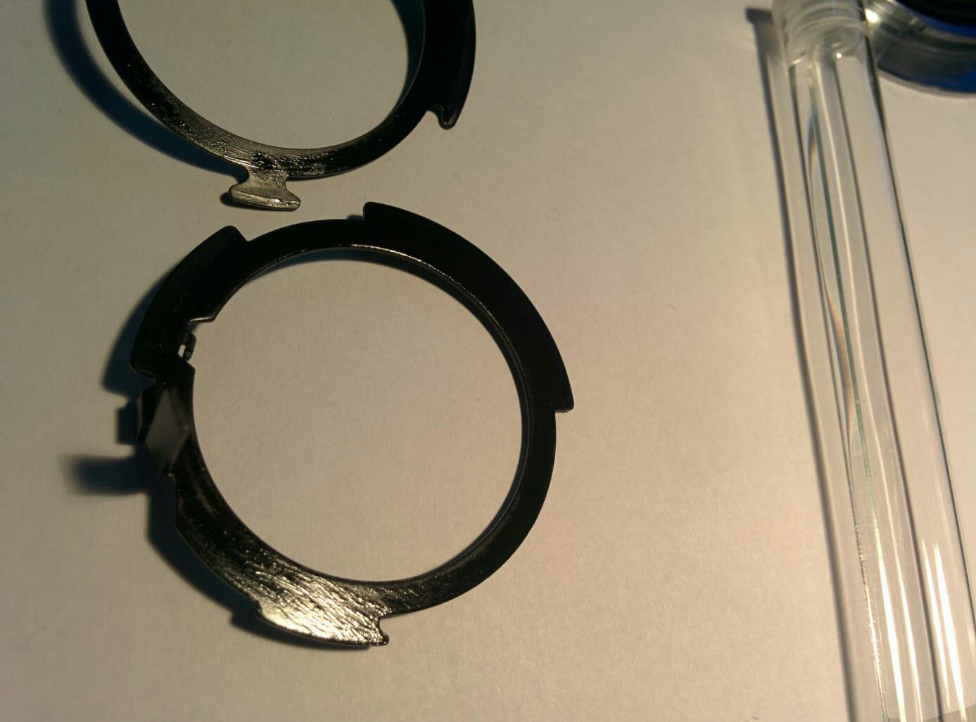

Yes I agree, that video is about how to disassemble an otherwise perfect lense.
I have just done however my fix for the same lense with the same sympthome.
Takes 5 minutes to fix it. All we have to have a proper screwdriver.
There are two black metal circular platforms when we take out the three screws and the one that fixes the back metal plate to the black back lens holder (4 screws! , the last one should not necesseraly to be taken fully out, otherwise there is a little game how to reinstate later that tiny little screw). When we have these twoes, there is an oil inbetween them, so little bit of alcohol (I had a tiny bit of palinka to be sucrifised for this purpose ) to clean it.
Yes, there is a spring too, careful, not to loose that and not to forget to reinstate at the end.
Cheers!
