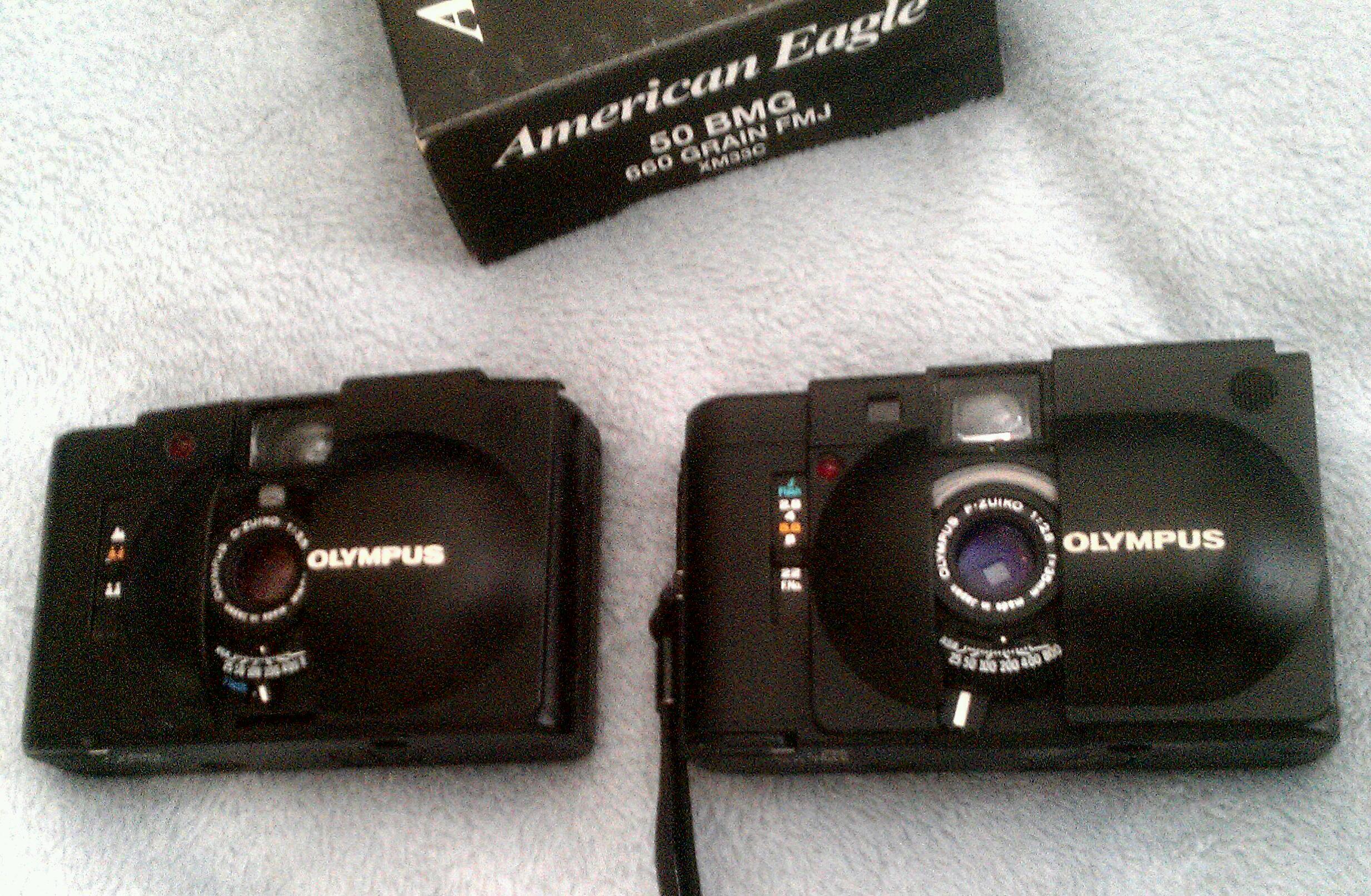

Better lens, actual focusing (XA2 is like a simple snapshot camera from the 70s - focusing is "Landscape" or "People Quite Near"), decent metering, and a little bit of exposure compensation (+1.5 stops for strong backlight)
The XA2 is fun and light and simple, but I'm always picking up the XA.
On the other hand, my XA2 cost £2 from a charity shop (complete with working flash unit) while my XA cost me €25 from an APUG man (bless 'im)
Flash unit works with either btw.
I had both of them, XA definitely is much much better. In comparison to Mju I and Mju II - I cannot justify Mju II higher price against Mju I, but for XA I can see why one pays more than for XA2.
Only thing that is better in XA2 is actually the same thing that is worse - zone focusing can be used as quick street point and shoot without much thinking about the focusing.
Having used both the XA and XA2 quite a bit, I can say the XA is better in every way unless you want quick grab shots.

Can’t control shutter speed. Lots and lots of blurred photos. Basically you have to shoot this camera in bright sunlight only. Otherwise make sure you only use 800 speed film.
It also sometimes doesn’t fire. I think that’s because it’s trying to figure out exposes. I need a camera that fires when I push the trigger. I’ve missed a lot of shots this way.
I shoot B&W film with filters and slides need warning filters too. This limits me to color negative film for the XA.
The flash system for this is useless in my opinion. I use flash at parties, dinners etc. indoor situations. The camera still tries to meter in that case. Meaning it tries to expose for 15-30 seconds the fires the flash. You can imagine the results.
The XA is better because you can force apertures.

Right. In the case of the XA, it's not a lost cause if you address it right away. With some finagling, the sliding cover will come off enabling a thorough cleaning. Afterwards, I think it worked better than before the sand incident. What you don't want to do is keep using it hoping it will work itself out.

I second that. Having both XA and XA2, it seems that the XA2 is getting much more use. Yes, the lens is a little bit slower, but the zone focusing and not thinking much about the aperture saves a few seconds of thinking which might be too long for this very moment, and the moment is over.
I actually like the XA better because I can shoot at f/5.6 and f/8. I don't want to use f/3.5.
If you have working XA hold to it. It will do everything cheaper XA2 will do, including auto-set of focus lever on opening, but it has more advanced lens, not XA2 4 elements only and it has RF.
I used my XA at f2.8 on the street and inside. And at 5.6/8. Not a problem. :smile:
Some people have suggested the 4-element lens is sharper at most apertures. I like the XA3 because it has higher ISO capability and backlight compensation. Re-setting the camera to mid distance when it's closed is also neat. Whatever, the XA series are pretty ancient plastic cameras and that should be born in mind if people are looking for a workhorse.
I'm interested in the XA4 with the 28mm f/3.5 wide angle lens and minimum focus distance 0.3m. It seems pretty rare these days - experiences ?
A photographer I used to follow owned one. He moved to other point and shoots, I think his XA4 failed at some point. They had a fairly short life and are pricey these days, in the UK anywhere from £100 to £260+ for a boxed example with flash. The XA series have a membrane shutter which tends to fail at some point. The exception is the XA1, an underrated camera with a conventional shutter and Trip style cell around the lens.
