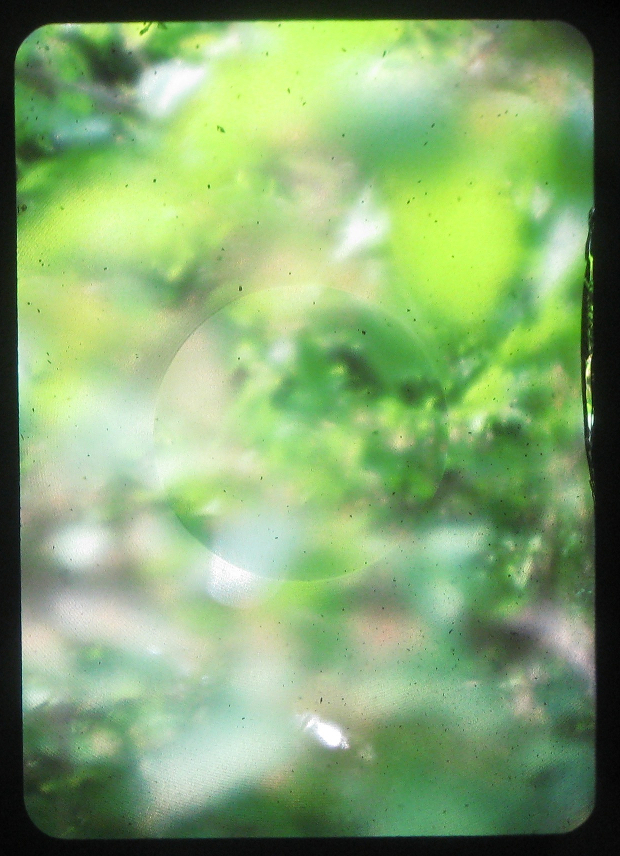

IloveTLRs -- as I read your post, the FT has a microprism spot (as I know from using my own) but the F does not? What is it, just plain matte screen?
Maybe these pictures will help. On the left is the viewfinder focused, on the right, out of focus (pardon the dirt - cleaning the VF would require disassembling the camera.)

Thank you, IloveTLRs -- that central spot really disappears when in focus, doesn't it? You've given me a lot to consider.
