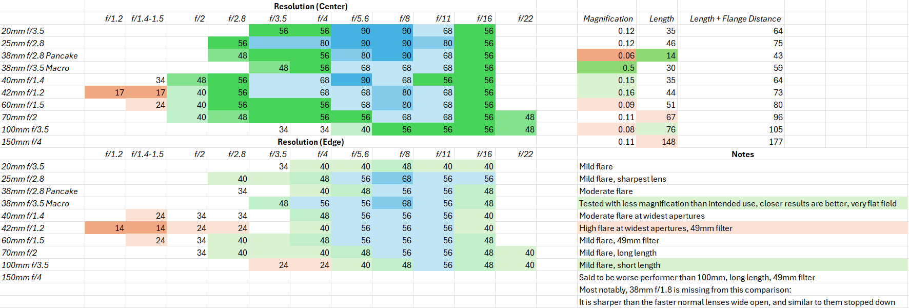

Adapted from this magazine article from 1969, I made a spreadsheet comparing 9 of the half frame lenses. As we know, these numbers can be more important when talking about small formats.
A resolution of 80 was the maximum the test could determine. Values of 90 imply it was above their testable limit, but it's unclear by how much. Judging from image samples online, values of 40 are high enough for very detailed photography.
Based on this information and current prices I'd personally select either 20mm f/3.5 or 25mm f/2.8 for the wide lens, any normal lens other than the f/1.2 or non-pancake f/2.8, and the 100mm for telephoto.
Feel free to share your own experiences with this system.

Not sure about the film used for the test. It would have to be a pretty detailed one to go up to their 80 figure - because in sample images I see online with these lenses mounted to APS-C digital cameras, they achieve maximum detail by the time they're hitting around 40-56.

Thanks for compiling the stats that you did, but I’d like to see the numbers for the 25mm f4 and 38mm f1.8, as these are the more common lenses than the 25mm f2.8 and 38mm f3.5 macro.

I'd like that too but I didn't want to mix numbers from multiple people's tests that might be using a different methodology.
The 25mm f/4 has poor corner sharpness that I think has to do with flatness of field - I'd like to know if there's ever an aperture where the corners become okay. Can improve shots where only the central subject is important though. Likewise, the non-pancake 38mm f/2.8 has poor corner sharpness.
The 38mm f/1.8 should be almost the same as the other normal lenses after f/2.8.

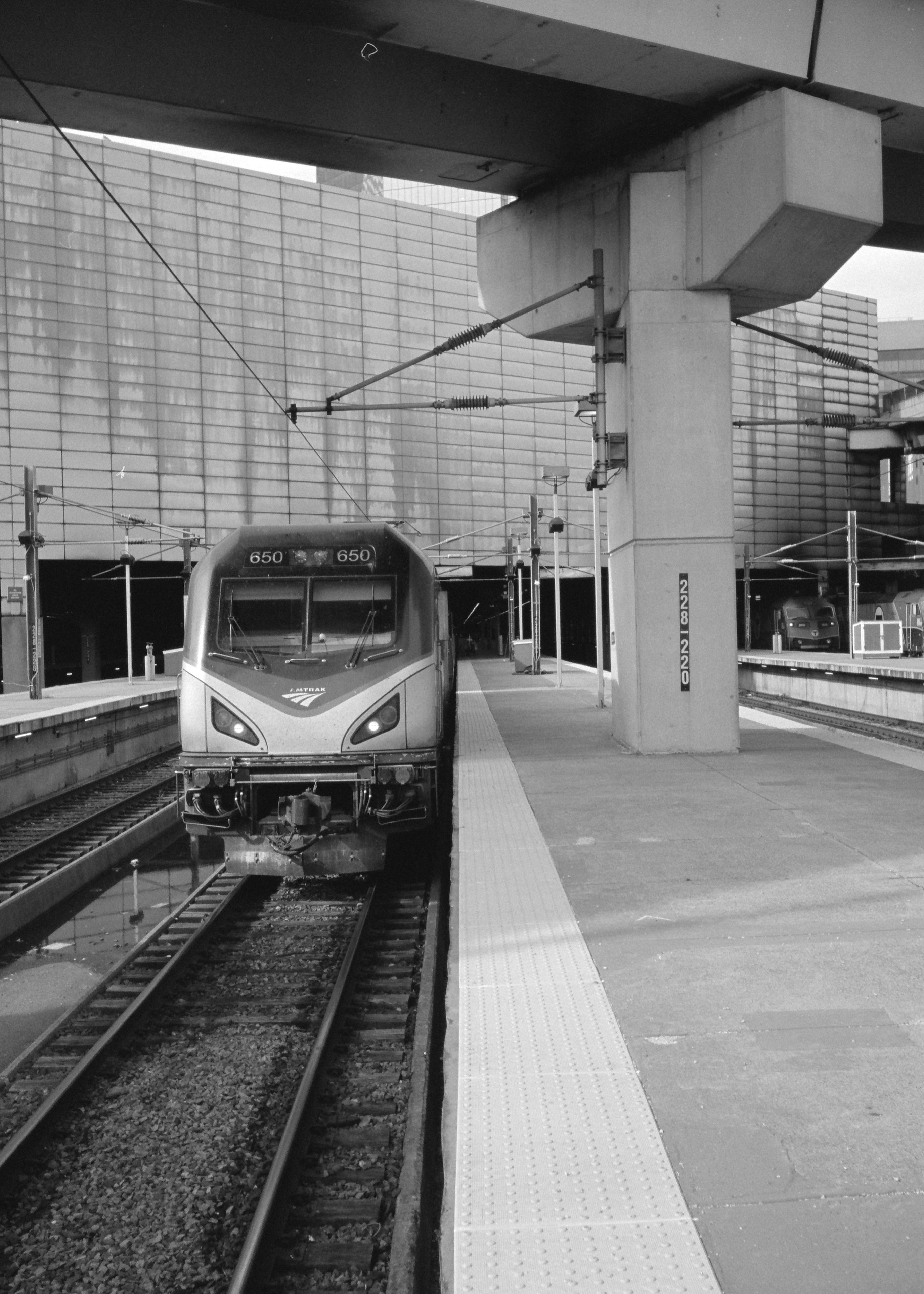

I don't have a pen f, but I can confirm impressive results with TMax 100 on half frame (Pentax 17). I've only made 5x7 prints of them so far but I have no doubt an 8x10 would look excellent.
