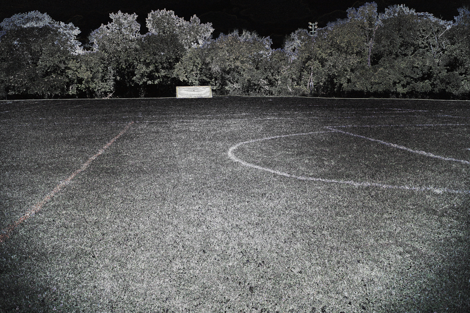

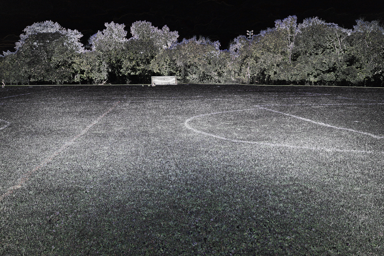

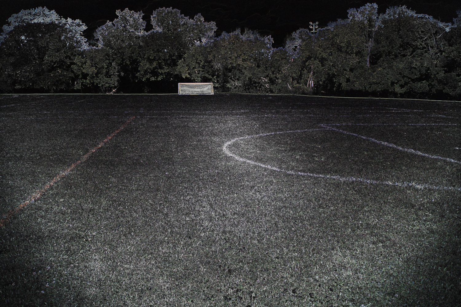

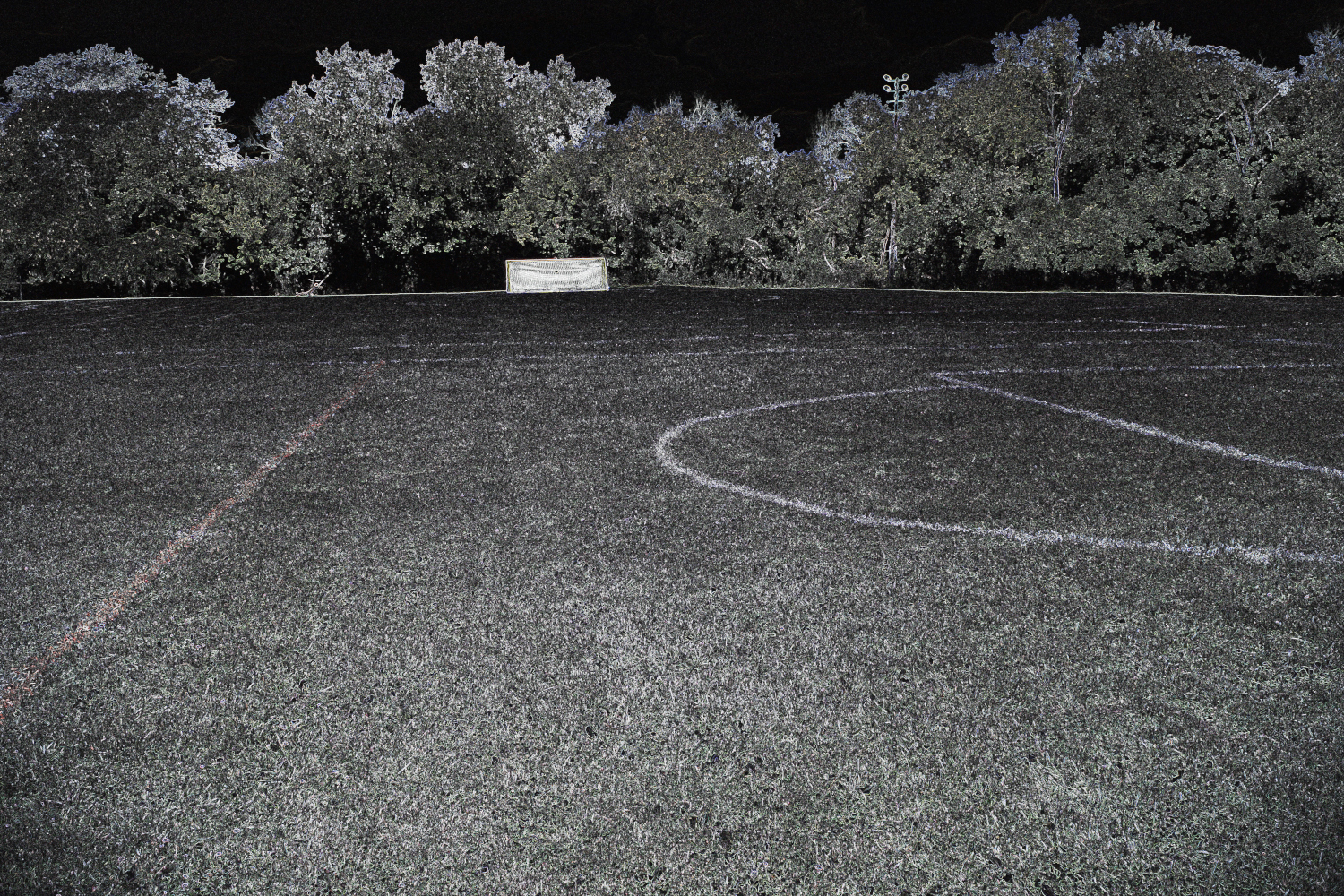

The 25mm f/4 has poor corner sharpness that I think has to do with flatness of field - I'd like to know if there's ever an aperture where the corners become okay. Can improve shots where only the central subject is important though.

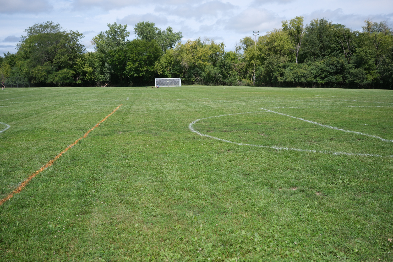

Attached are three color images of a mowed grass field shot with my Olympus 25mm f4 on a 40MP Fujifilm X-E5. They have been processed in GIMP with the Edge Filter using a technique described in DP Review by Roger Cicala of Lensrentals that can give you a rapid idea of a lens' quality. The edge detect filter acts like focus peaking on a digital camera, so the whiter areas are in sharper focus.
As you can see, the lower corners are darker (less sharp) than the center at all three apertures. The corners are best at f16, but overall the image is not as bright (sharp) as at f8.
Also attached for comparison are images taken with the new Fujinon 23mm f2.8 WR kit lens wide open at f2.8. All images have been resized from 7728 x 5152 pixels to 1500 x 1000 pixels to bring the file size under the 2MB Photrio upload limit.

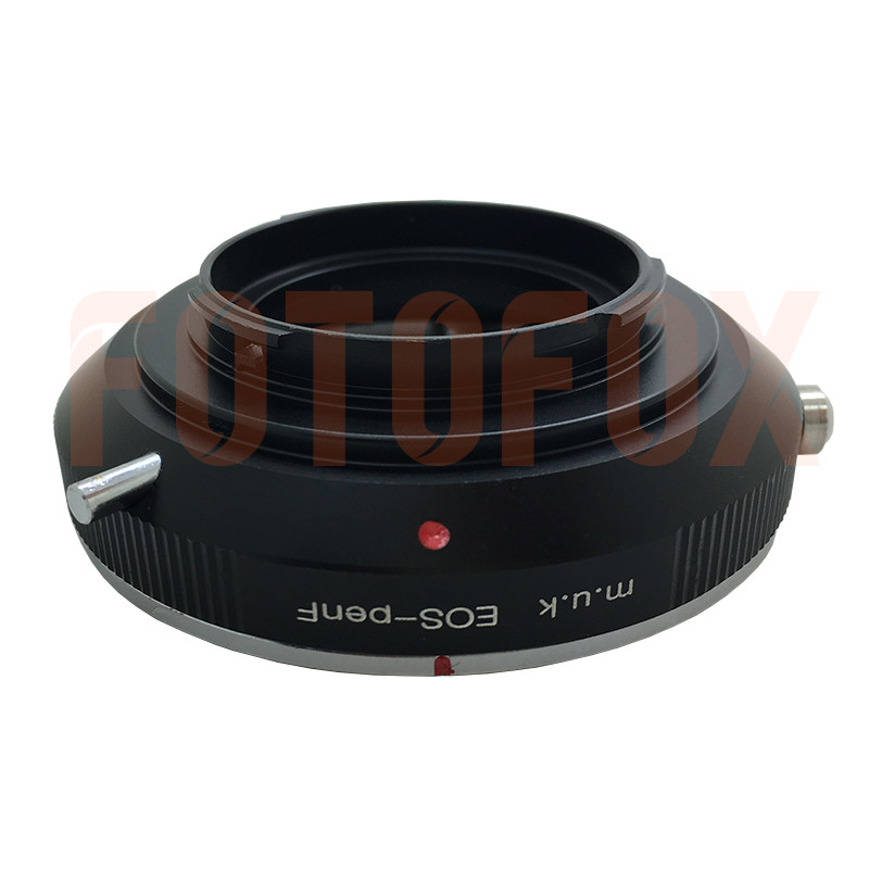

Which adapter are you using?

This Chinese one here. It's the most affordable Pen F adapter that I saw.
