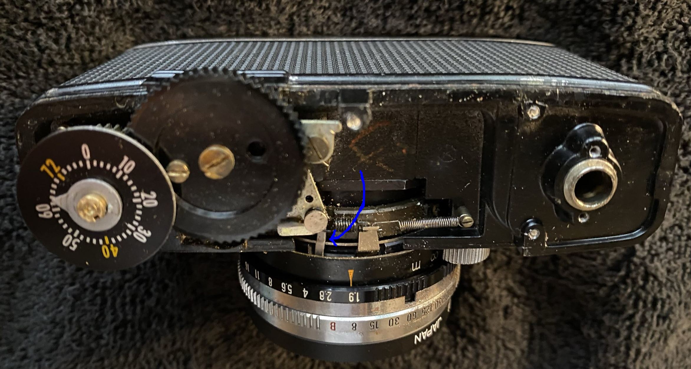

Being not much of a camera repairer, I was still able to fix my Olympus Pen D which had two issues. That should show that just about anyone can do this.
1. Camera Fires on Wind
2. Camera Allows Winding Multiple Times Before Firing
These are both two sides of the same issue. Connecting the lens/shutter and body there is a ring with an arm:
Unfortunately, this is made of a very soft metal. If the arm is bent in one direction, you get issue #1, and the other, it's issue #2.
The best way to fix this is to bend it with a screwdriver very slightly while the top and viewfinder assembly are removed. Then wind and shoot the camera a few times to confirm the problem is fixed. You can shoot the camera while the shutter button is removed by pressing a small screwdriver into the hole the shutter button occupies. While the top is off it's a good opportunity to clean and lubricate the parts there. I used isopropyl alcohol and then clock oil.
It's also possible to access this part without taking the top off, by disassembling the lens/shutter area. However, re-bending the part this way is more difficult, because you will have to guess the correct amount to bend it, and reassemble the lens/shutter in order to test it. If it's wrong, you have to take it all apart again.
In taking the top off, one of the screws broke in half. While taking the viewfinder off, all 3 of its screws broke. If this happens to you, it's okay - the viewfinder can be held somewhat snugly by the top plate alone. It seems they were using a pretty strong glue on some of these screws.
Now that it's back together again, the camera does its advance and fire cycle properly.
