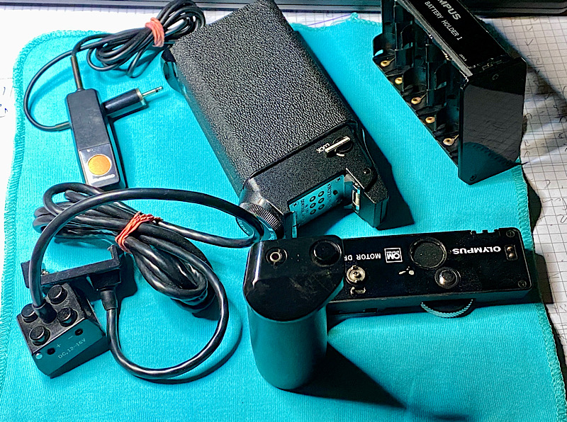

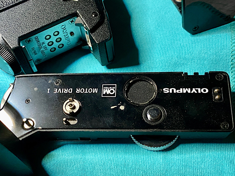

I found a nice set for motorizing OM cameras at a local photo shop here in Vienna.

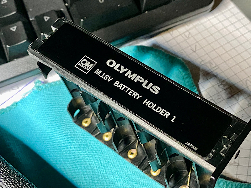

The Motor Drive 1 is powered by 18 volts from 12 AA batteries, which the M.18 Control Grip with Battery Holder takes.

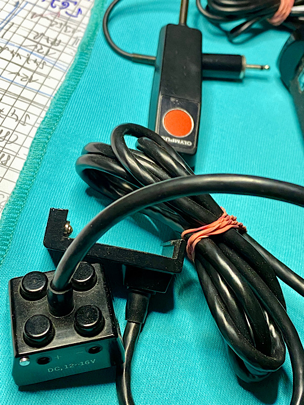

The Relay Cord 1.2 m allows the motor and control grip to be separated. This makes the camera lighter and when it's cold the batteries can be kept in a warm jacket pocket.
The M. Remote Cord 1.2 m can be used to trigger the camera from a distance.
Everything is in good condition, there was some corrosion on the battery holder due to battery electrolyte, a test is still pending.

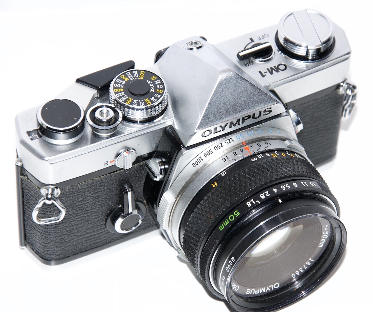

Are the OM 1s motor ready or do you need a MD version?
There aren't a lot of pre-MD versions of the OM-1 out there. And of those, a reasonable number did receive the customer requested post-purchase factory upgrade to motor drive compatibility. It was the unexpectedly large number of requests for the upgrade that quickly convinced Olympus to start incorporating the motor drive connection mechanics into all of the newly manufactured OM-1s, and to badge the result as an OM-1 MD.
Not motor drive ready, "OM-1"
Motor drive ready, starting in 1974 "OM-1MD", and "OM-1n"
Unless the OM-1 was subsequently factory modified on customer request, as many were.
I don't know whether Olympus stuck an "MD" badge on the front of the modified ones when they did the modification.
Simple enough to look at the bottom plate of the camera, to see if TWO acccess ports are present...the second one (away from end of camera body) is for motor drive

Got this when it first came out. Owned since 1973. Pre-motor drive. I switched almost exclusively to 120 film in 1979, so it did not get much use. Then got into the Rollei 3003 system in 1984, so, again, the Olympus did not get much use.
