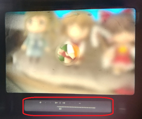

Hi everyone, I’m having a problem with my Olympus OM-4 and hoping someone might have some insight. I bought it from a garage sale when I walk along my local. When I got back home, I put fresh SR44 batteries in it and it working. But with some deep inspection, I found that: The LCD display reset and freezes whenever I cock the film advance lever although the light meter still works and the camera adjusts shutter speed correctly in Auto mode. I have tried to advance film while poiting at sun litted white wall and cover the lens with my hand, camera still adjust shutter speed to really low due to my hand covered the lens. In reserve, I also cover the lens with my hand and advance film, then I pointed to the wall and press shoot, again, camera adjusted shutter speed for (maybe) correct exposure of the wall. When not in state of cocked, LCD's working fine in both manual mode/auto mode and spot meter mode.
Has anyone experienced this before or know what might be causing it? Any suggestions or advice would be greatly appreciated!

In OM4 viewfinder, there is a small LCD to display information like indicator of shutter speed, spot metering mode, highlight/shadow,.... When not cocked, this LCD works normal, it will indicate the shutter speed and change indicator depend on where I am poiting at. When I ever I cocked, this LCD will reset and freeze up, indicator will stand still even I point the camera into light source or cover the lens or press spot meter button or slide Memory button. But it still determine correct shutter speed based on where I point the lens at the time I press shutter button.
