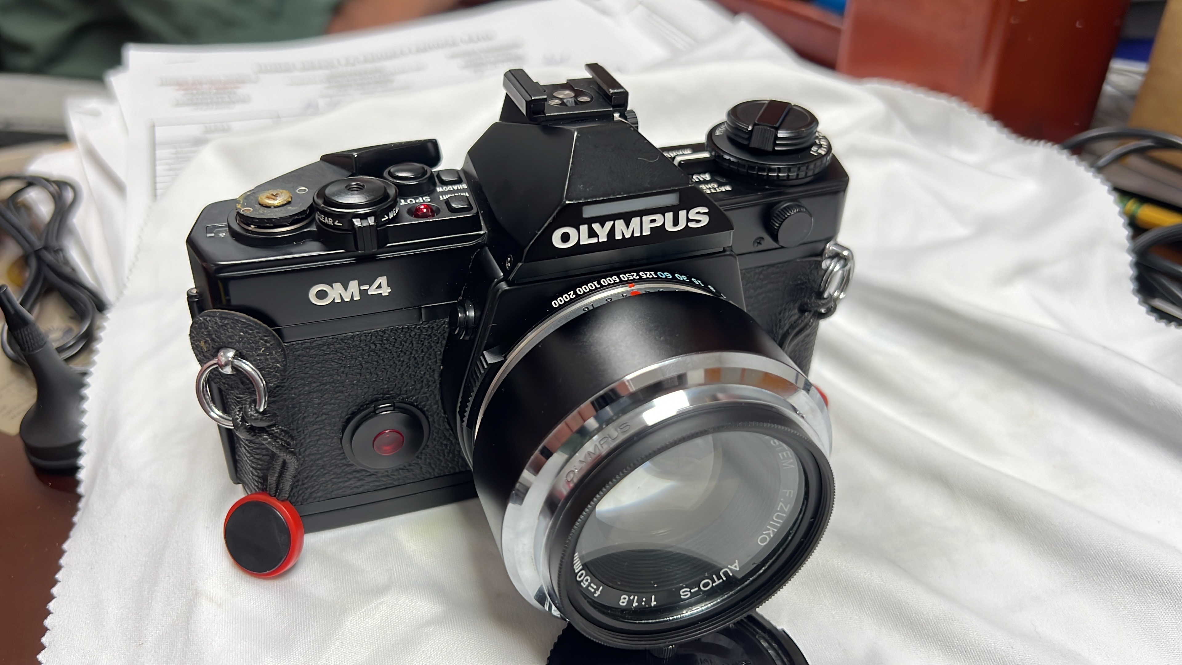

Hello all!
I have one weird issue with the electronics on my OM-4.
Camera has worked beautifully since I have it, but today it has been quite the interesting day.
After cleaning of the spring, battery cover and threads - not that they were dirty anyway, but this is what I have always read when having a black battery compartment cover - the battery finally started up the camera and electronics. Battery check works perfect (steady LED and beep). I always store my cameras with batteries removed.
Now, my issue at the moment is that I can do the spots, highlights, memory functions, BUT without advancing. As soon as I advance, all clears up in the display, and no matter what mode I set, the display will not reflect any reading/settings, even when slightly depressing the shutter button.
As soon as I shoot, I can take all readings display works beautiful. As soon as I advance again, all goes blank and no metering /readings are able to be taken/displayed.
Batteries are new Eveready 357… hope that this is the case, if anything, as I have read that these are SR44 substitutes.
Appreciate your feedback, as always!
Jorge
