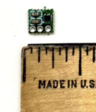

This is new since I posted 2011 about a tiny voltage regulator. The engineering to get these micro voltage regulators on a little pc board had been done and the fully soldered assemblies are easy to obtain on the internet:
