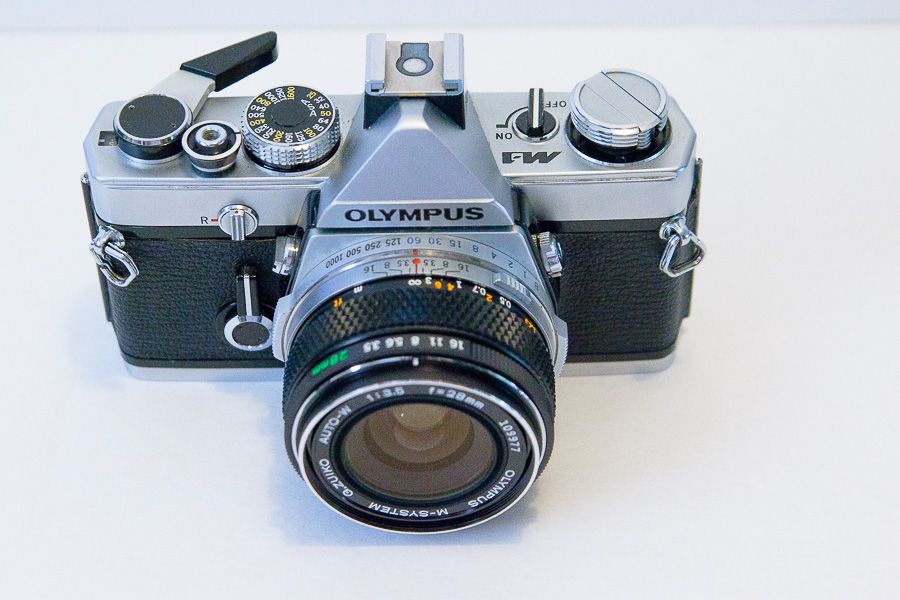

Wow.....the camera in that link is an M-1.
How many of those did Olympus actually make.?
Supposedly Olympus had stated that 52000 M-1 bodies had been produced. I am the proud owner of one of them, with two lenses with the 'M system' engraving identifications (not the 'OM system' lens designation.
