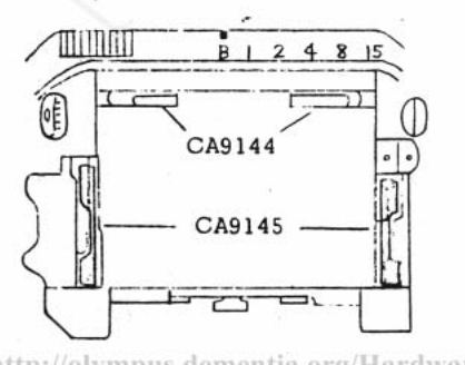

Service manual, pg. 144:
So, the adjustment is by washers, so the focusing screen position is changed.

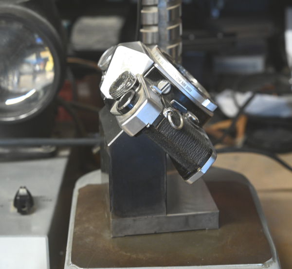

Mirror angle is not likely what is causing your issue unless the camera has been subjected to some type of trauma. In fact, mirror angle on the OM series is not simple to correct- the mirror box needs to be removed to reach the adjustment lock screw and it is sealed in place, a clue that Olympus feels this is not a common adjustment. Also, the manual that is often linked to is for the early OM-1 and the mirror angle stop mechanism was changed soon after production. And, adjustment is made not by raising or lowering a spring, but by changing the position of the spring stop. The spring is used as a shock absorber. I have attached a photo of how I check mirror angle on cameras - it shows a forty five degree fixture resting on the film rails of a camera body and an autocollimator squirting an image to the mirror.

Hi, thank you. Yes, I agree with your explanation. Mine was imperfect. It is the adjustment of the spring stop. Your approach seem good! Did you design or buy your 45 degree fixture and/or autocollimeter. My mirror is off angle… just deciding the best way to return it …
You really will need a 45 degree fixture and an autocollimator to adjust the mirror. I have had my test equipment for many years, it is mostly factory repair tooling.
