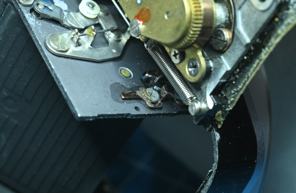

The OM-1 does indeed require the mirror box to be removed to adjust mirror angle as is necessary on the OM1 through the OM4. I have attached a photo and in the middle is the mirror stop adjusting plate. You can see how the lock screw is loosened from the side of the mirror box.

You won't be able to make an adjustment this way. Also, keep in mind that mirror position needs to be within 5 minutes of arc!

Mirror stop location
