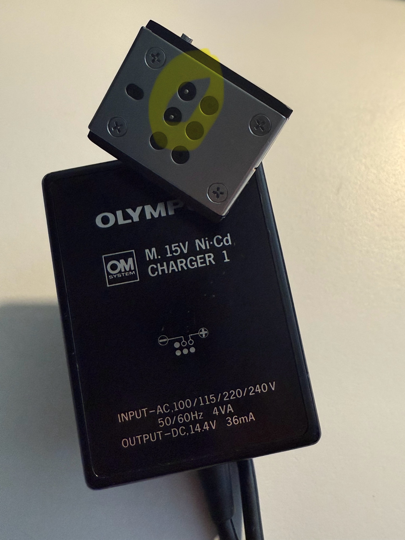

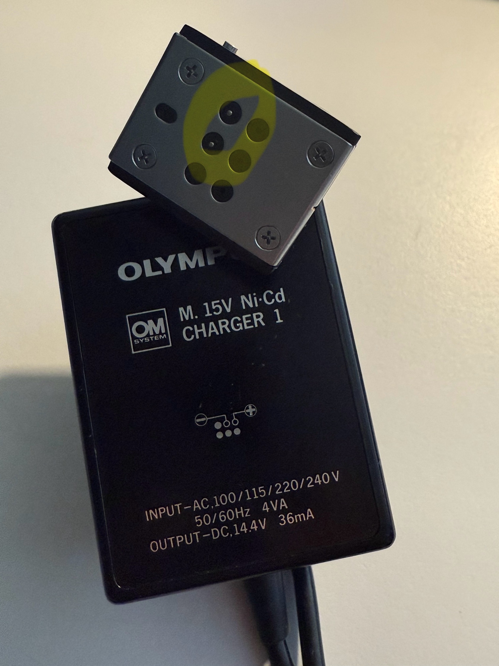

So, I have this charger that should be putting out 14.4 VDC. Mine is putting out .4v. I am measuring at the pins at the end of the charging block, but I wanted to ask anyone with this charger if they read the correct voltage without out the charger connected to the battery. I’m unsure if it needs to be connected to the battery before it will output the correct voltage.

Nicad chargers are generally pretty simple things. Examining photos of it, I see that there needs to be a single voltage selection screw in the correct spot, but otherwise, you should be seeing a lot more than 0.4 volts under no-load conditions.

I think the voltage is measured directly at the charger's output, which tells you whether it's within the specified range.
If there's no voltage there and the batteries are connected, that sounds like a short circuit (~0 volts).
koraks
Nov 29, 2018
22,076
Europe
That's apparently not the case.
0V is quite not the same as a short circuit and indeed, a charger outputting 0V (or rather, close to zero but not quite) is in all likelihood not shorted at the output.
Probably not. Sounds like your charger is dead. Maybe there's an electronics enthusiast near you who might be willing to diagnose and perhaps troubleshoot it. Stuff like this often turns out to be repairable.
That is my thinking as well.

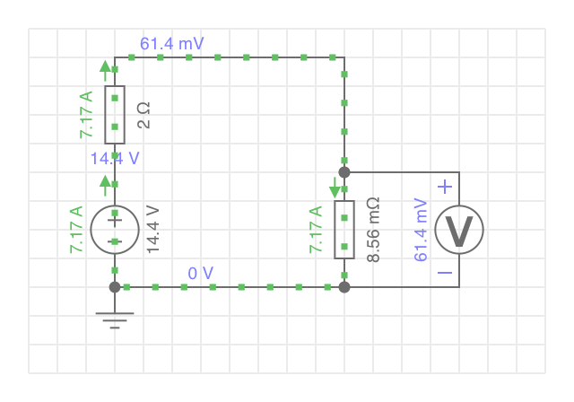

Equivalent circuit
  • Voltage source: 14.4 Volts DC
  • Load: 0 ohms (short)
  • Internal resistance of the voltage source: 2 ohms (or higher/lower)
  • Load (resistance of the copper cable/0.5 mm, 10 cm length): 8,55 milliohms
  • Voltage drop on the line: 61.4 mV
The 14.4 volts remain at the voltage source. At its output, you measure close to 0 volts due to the short.

If a voltage source is short-circuited (e.g., with a thick wire), its terminal voltage is 0 volts. The total source voltage drops across the internal resistance
Leonhard Stiny, Grundwissen Elektrotechnik und Elektronik. Eine leicht verständliche Einführung, 7. Aufl. 2018, Springer Verlag
My esteemed teacher, who is unfortunately no longer with us.

So, if anyone has this charger and you have a meter, I would be grateful if you could plug it in and measure the voltage on the two pins.

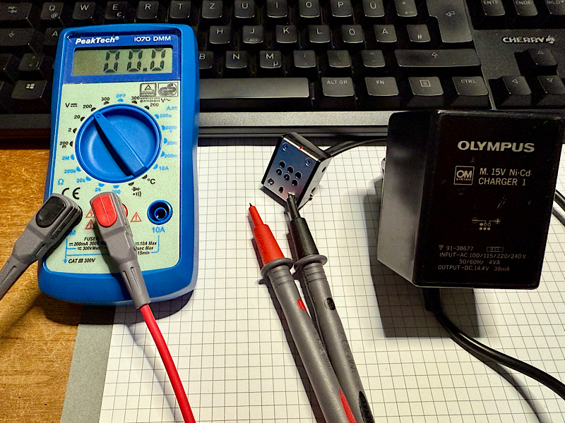

So, if anyone has this charger and you have a meter, I would be grateful if you could plug it in and measure the voltage on the two pins. View attachment 399065
Connected to mains 230 VAC (Austria): 28 VDC open-circuit voltage.
That's twice the output voltage indicated on the rating plate.
I hope my charger isn't defective.

Wowza, that's a half-watt charger. Trickling with a vengeance. That's a very dumb charger, designed to be disconnected after 6 hours, but not damage the cells if you do leave it connected. OP, has it worked in the past? Has it worked recently? Or is it new to you? I'd probably remove and reinsert the voltage selection screw just to make sure there's no corrosion on that side of things. There is a "built-in safety device" (i.e., fuse) which can be replaced by a service center, so I'd probably have a peep inside to check the fuse which is almost certainly OK, then check the voltage before it gets to the charger cord.

Andreas, I don't think this analysis is correct. If the source is shorted (de facto + connected to - internally), the copper cable to the output is in parallel with the 0 ohm short, not in series. If a source like this is shorted internally, probably you measure 0 V at the output and it gets really hot really fast. Then the magic smoke comes out and it doesn't work any more.
I would more suspect a damaged wire in the output or the connection of the transformer to the internal circuitry.
Regarding your copy of the charger, I think these types of dumb chargers for NiCd and the like usually have a fairly high no-load voltage and drop closer to the rated voltage when the load is connected - meaning, the internal resistance of the charger source is comparable to the internal resistance of the battery. The fact that your charger's output current rating is so low means it has a high internal resistance and connecting a load will pull its voltage down.
As an example, I just pulled a transformer-type DC adapter out of my box of such junk (used once upon a time to charge an old bicycle light, before Li-ion batteries). It's rated 9 VDC and 300 mA output. Connecting a DVM across it with no load, it reads 10.7 VDC. This is not as extreme as your example, but this one has a higher output current rating so it would get pulled down less.

What could be causing my charger to have double the output voltage? I suspect it's a transformer, a rectifier, electrolytic capacitors, and a voltage regulator.
I'm not sure there is a voltage regulator in a transformer based dc adapter of this vintage. Your adapter has some internal impedance, which translates to a resistance in DC terms. The batteries also have some internal resistance.
This charger is intended to charge the battery pack at a very low current, ~ 36 mA, which is much lower than the output current the batteries are capable of - it's a slow or trickle charger. That helps preserve the batteries on a dumb charger. That also suggests the internal resistance of the charger is significantly higher than that of the battery pack.
Regardless of vintage, it's effectively a current source. Within a certain margin, it'll generate whatever voltage needed to push that 36mA through the load. Of course the voltage cannot rise infinitely, but the point remains that it makes no sense for this device to be voltage regulated given its very nature.
