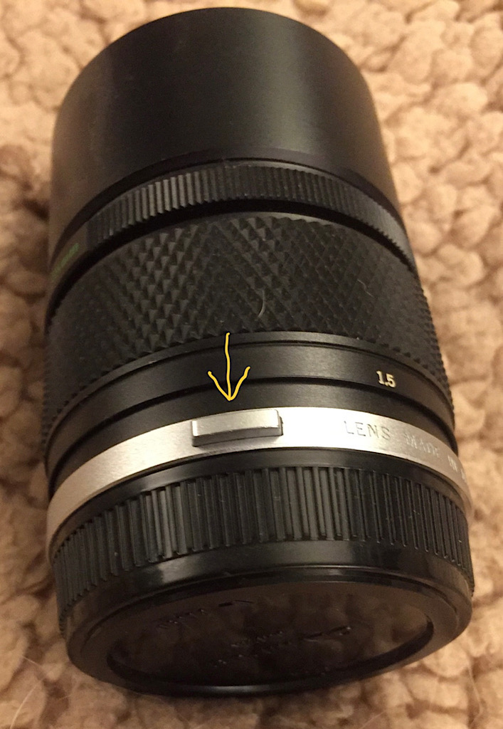

If you press and hold the depth of field preview button you should the aperture close down. It's the smooth topped button on the opposite side of the lens mount from the ribbed lens release button.

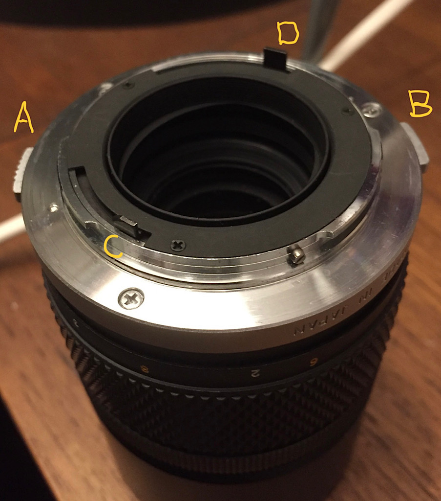

There should be a lever in the side you can push to stop down the lens. If you mount it on an Olympus body it will stop down when you fire the shutter. I have an Olympus Pen F kit and should work the same for OM series.
Looking at the rear of the lens mount:
  • A is the ribbed top lens release
  • B is the smooth topped depth of field preview
  • C is the lever that closes down the aperture when the shutter is released
  • D is the lever that moves when the aperture ring is turned to communicate the chosen aperture to the camera

It's an OM lens, but neither the DOF button nor the lever marked "C:" stops down the lens.
So I guess it's a repair bin lens.
Yes, sounds like there is something amiss inside. That's a pity. I can't recall the details of the internal mechanism and whether there is a possibility of something being out of alignment or whether it's more likely that something is broken.
Yep mostly something disengaged inside the lens. On my few lens repair forays, I remember Olympus lenses not being overly complex but then again, wasted a good 50mm on that foray so probably that lens previous owner was someone like me.
Oil might have crept onto the blades and frozen them open. This is a common problem with lenses for SLRs.
Yeah. I notice that when the stop-down button is pressed, the lever on the rear rotates -- as it should -- but the aperture blades don't budge. Still it's usable as is, and being a 135mm stuck at f2.8, it should make a great portrait lens.

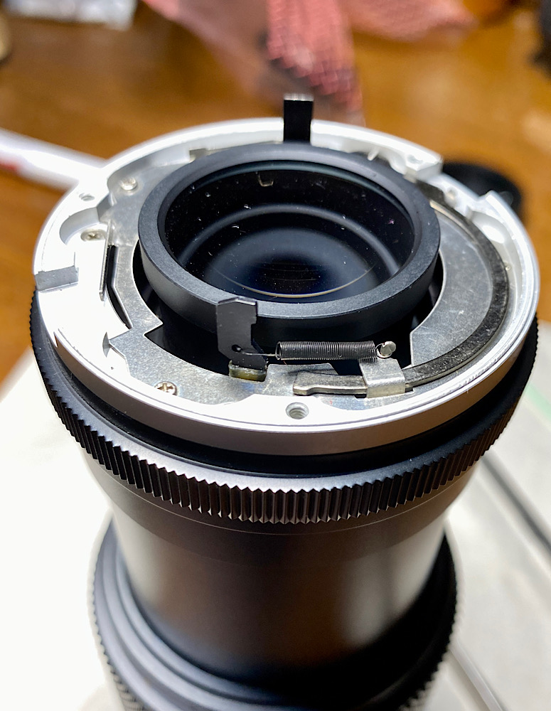

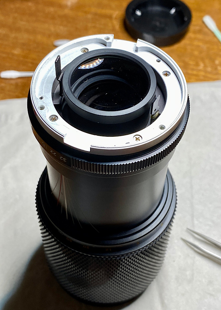

The mount for OM is not that complicated. You could open the lens from the back and check whether the transmission of the stop button works or whether the aperture blades are oily and therefore do not close.
This is the mount of a Zuiko 65-200:
