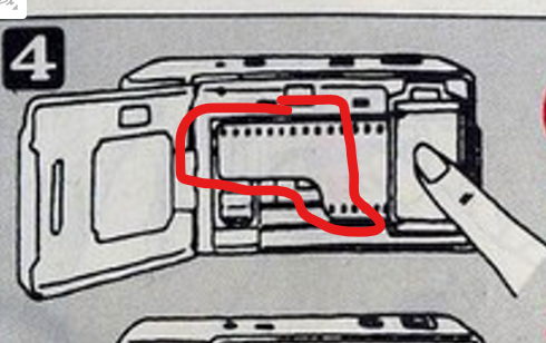

Help me figure out the problem, maybe I don't understand something, since this problem is already with the second camera. I have an Olympus AF-1 that I shot with for about six months, and then after it lay on the shelf for a while, it stopped charging the film. This happens like this: I insert the film, close the lid, and the camera immediately reels off the film. I bought a second camera and found the same problem with it. I recorded a video of how this happens (I pressed all the limit switches so that the camera would work with the lid open for clarity)

From the video, it appears that the camera isn't "grabbing" the leader when the film is placed where it appears that the film end is supposed to be placed.

Yes, I've read this manual, but I don't understand what I'm doing wrong. It seems that after closing the lid, the camera first rewinds the film back into the cassette and then rotates the receiving spool.
I just realized that you are trying to load film that is cut straight across at the end. When that camera was new, film wasn't available that way. Try it with the film cut with a loading tongue instead.
Something like this image from the manual:
