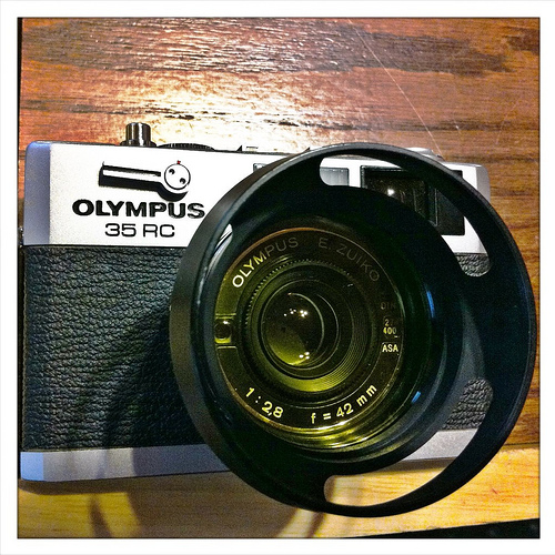

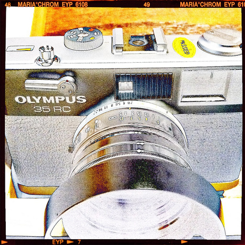

Those cameras are awesome. I had an Olympus RC that I gave to photojournalist in India a couple of years back. I thought he would appreciate it. the Lens on that camera was awesome. The problem with the meter in the camera is usually the dead cell on the lens. I just used my light meter app and my phone and snapped away. 7290055086_fa18437a64_k.jpg 7000062175_13238b1c22(1).jpg 7000061205_b0e420141f.jpg
