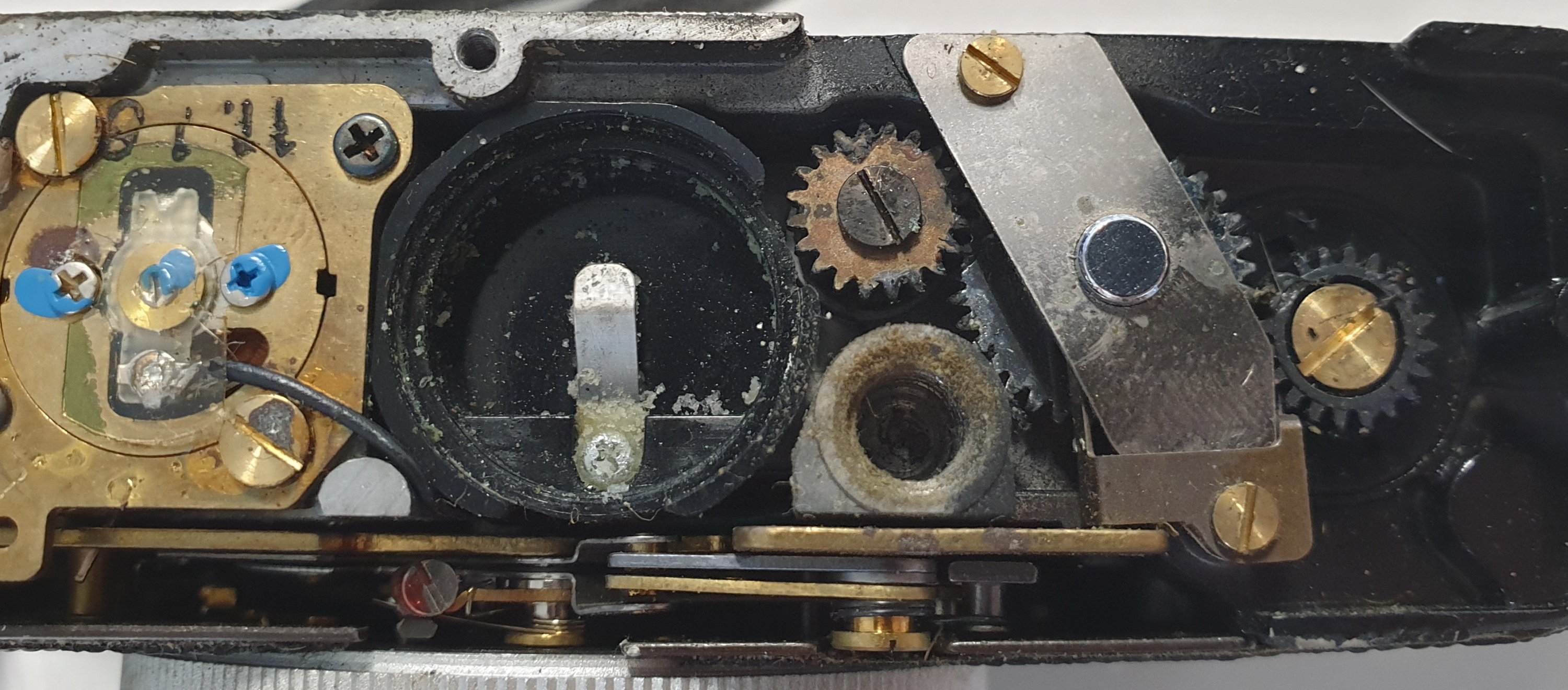

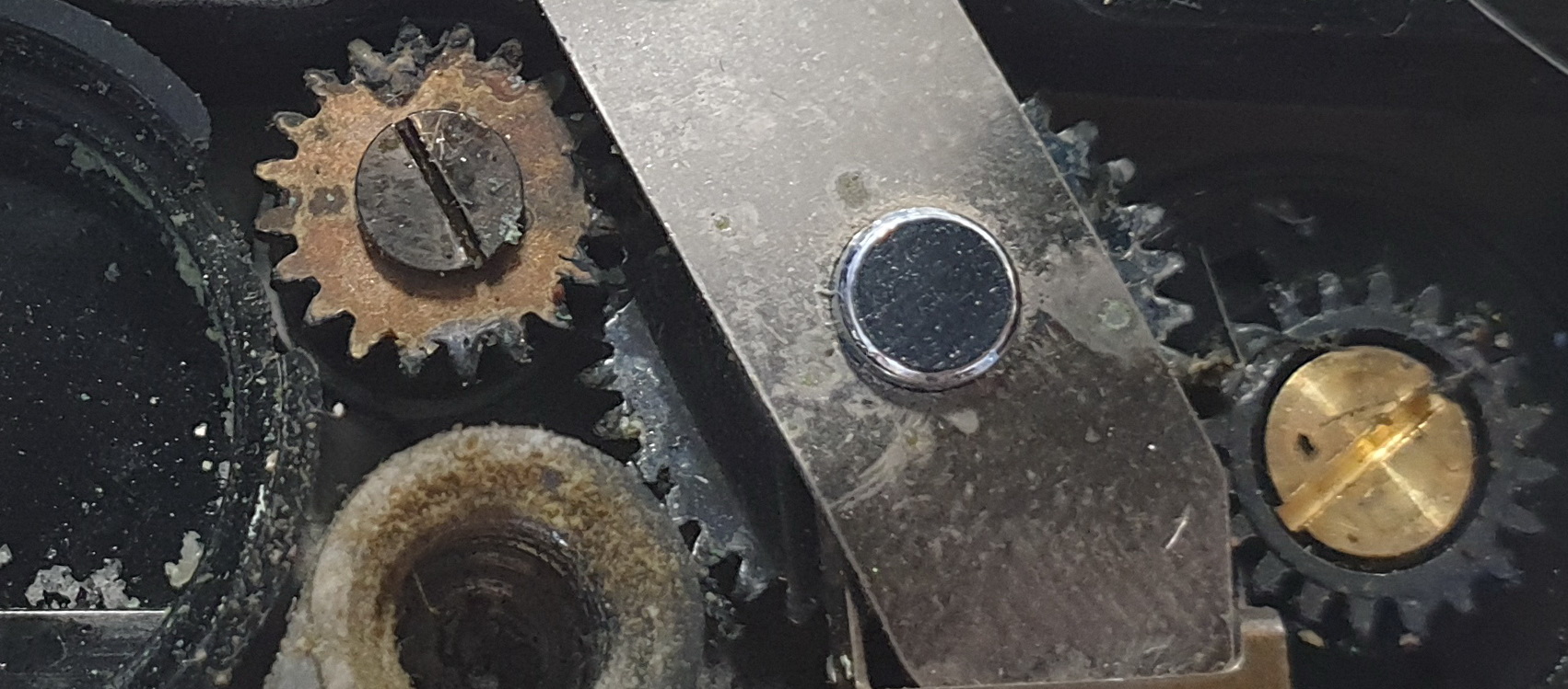

Update.....as I can keep the camera I decided to take the bottom off and have a look. As far as I can tell the small copper coloured cog is connected to the sprocket wheel and will not turn. The reason that I can get the shutter to fire if I depress the rewind button is that it moves the larger silver cog out of the way of the copper one.
I am far from the world's best mechanical engineer so can anyone offer advice? I'm tempted to put a drop of oil on the copper cog but I do know that's not always the best thing to do.

Everything on the top seems to be OK...the wind lever moves easily and the take-up spool rotates. The problem is when the silver gear on the bottom engages with the copper coloured one. That copper coloured gear and the sprocket wheel (which I believe is connected to it) will not turn.
I have tried a little disassembly and couldn't actually get that copper gear off as the screw is too tight with a very narrow gap for the screwdriver. I dried one drop of oil just in case it might help...but no luck.

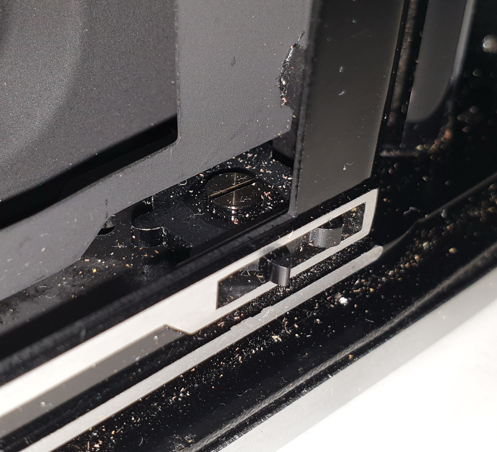

Just looked at mine and I can turn the sprocket wheel with my finger with and without the rewind button being pressed. There doesn't seem to be much there , just the small copper cog connected to the sprocket wheel. Can you see anything jammed in that may stop the sprocket from turning see pic
iJRy4tULJ7NT_6HHn72xCDwmRzxh4TdOPg2Wb62VotZjeUiTyNmAsnBfXpeeXEhew9m6jT81SqqIr7c5Ct9IWmSL4FYNRwijlAMUqs8BgP3zpey0psmJlXsND7VFzQBN4t1SG8aoEwyCWBPSe2c7QICXQVNx8a9k5tll8lz1U_puFrbtPOwntCTjrA15mLjhfv8Dmy3j9iyYqLiKBNlnQ9jkeahTJXYhtV2m2owwjXkyGpRm1TY48NOImh5hf-cpEAjBTwMquIgIMLfqpSVNtcfTjL4Tmvwa0cRCH47B_Ufxi565budjYbg6v1Usf9id_hqSjjG2mLn6VoQLF77GiObCz2V0iXmAYSR4llU2q-uI2ddCXby9QIGXtcY4OAzTkpArqOPI2jP7dzvF6paOuQByDIyfgZzbZKOQ-XQIFp93bsFkA-VerOufvgU0qpmjEI7SLBF7aEhX75g4PcUT3iUXepVJeDm_eKr1tKnaeYNQSbdNqzhlDmhDoTJHzlGE27_sLceYzpoa-9LYDZ79GziMrXzxq42g3mH1JhipXA0YF7OIxQJmbIQ0ppVzIZ2LnDTOwG-I_fy4oN4gECrLr9LGmsGP2K7mlqKcB3zPgxwE2Iyk_li3GsLaKOZ5MYUEuz8o0J2WAKZPJ_lrJjOCaxf46NLrseQ=w1158-h868-no
Other than the fact that mine could do with a good air blow I can't see anything to jam the sprocket wheel. Photo attached. I certainly cannot turn the sprocket wheel. It's jammed stuck.

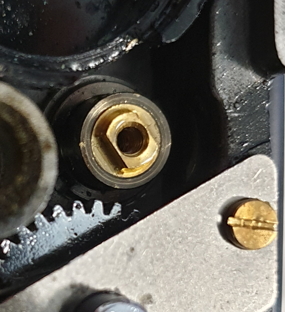

I think you are going to have to take the copper gear off to see if you can get the sprocket wheel to move without that on. I had a look at mine and the screw undoes with a JIS 2.3mm screwdriver
With the copper gear removed I still cannot turn the wheel. What I see with the gear removed is this. I'm at a loss for how the mechanism could be so stubborn.
