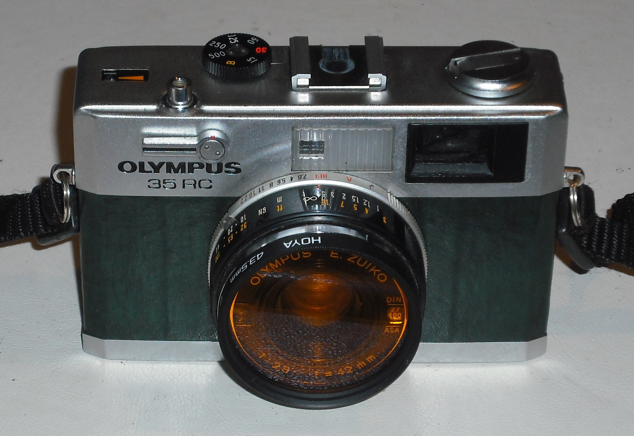

Hi,
The camera is well worth keeping, whether the light meter works or not as it can be used in manual mode with the aid of a light meter or Sunny 16 rule.
My 35RC was given to me with a box of other non-working cameras (perhaps 30 years ago) when a local camera shop was having a clear-out. Most were easily mended and the problem with the 35RC was simply that the wire to the meter had corroded and was no longer attached to the tag of the battery compartment. It was a simple cure - just a quick soldering job. As for a battery, since mercury cells became unobtainable I use an LR/SR44 and a rubber spacer with no problems. As has been said above, these cameras are capable of giving very well-exposed negatives that are fine for b/w work. I normally use Ilford HP5. After fixing mine, I treated it to a new green leatherette finish from CameraLeather.
If you decide not to keep the camera, I shall be pleased to let you know my address......!!!
best wishes,
Steve

Hello Dam,
The problem was very simple to fix for anyone with basic soldering skills. It was a long time ago, but I don't remember having to disassemble very much to gain access to the battery chamber tag, possibly just the base plate but I don't remember whether the battery compartment comes off with that or was held by further screws. At that time I didn't make notes as I do now! The meter does not need re-calibrating as a result of the soldering job (if that is the problem). Calibration of the meter in the 35RC is done by a mechanism that takes the meter needle position and then converts that value to a point at which the aperture blades will stop their closing action. It's a clever arrangement that was used in similar ways by many cameras of the period - I think the Canonet used it. The exposure mechanism can be adjusted but unless there is a problem it is best left alone.
Best wishes,
Steve
