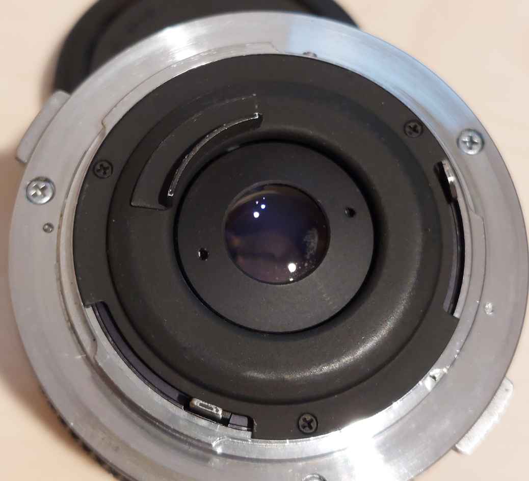

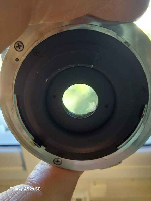

In my case, the lens has fungus on the rear glass as shown here, so IDEALLY it makes sense to try to remove just the rear and clean it.

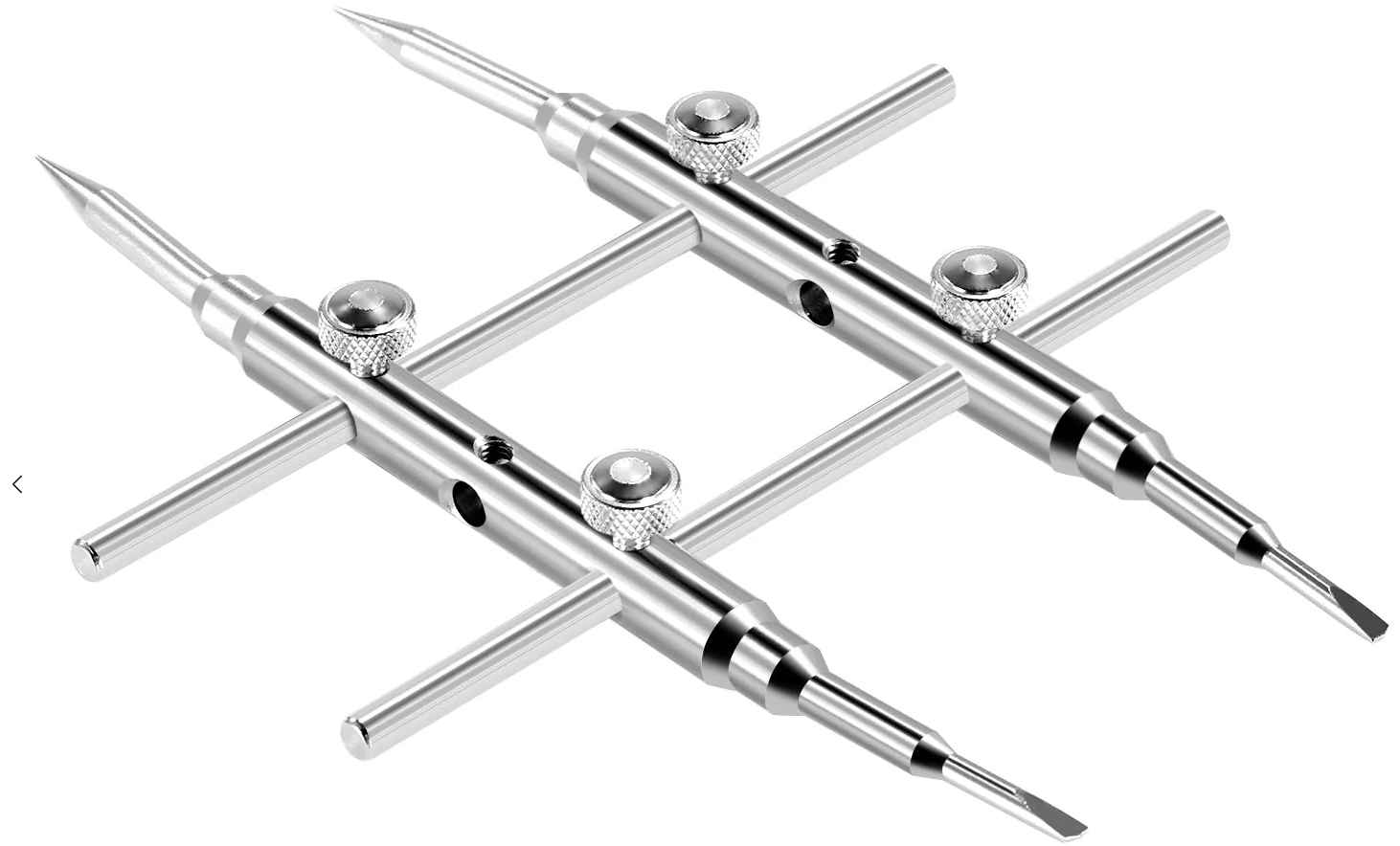

On that point, I see different wrench designs. Some allow the points to be installed at right angles to the main frame.
This would seem to provide better leverage to help out .
Others like tjis Neewer design, just install points vertically, so I'm guessing that's less leverage.
All advice welcome
Thanks
I would simply start disassembling from the back and see how far I get. If it is a glued lens group, the usual methods will not help.
I have both of the spanner wrenches you showed and I usually work with the lower one. Here you should make sure that the blades or tips are firmly in the recesses on the lens so that they do not slip off.

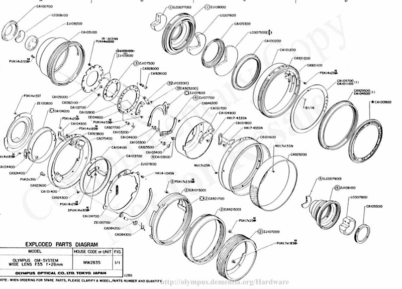

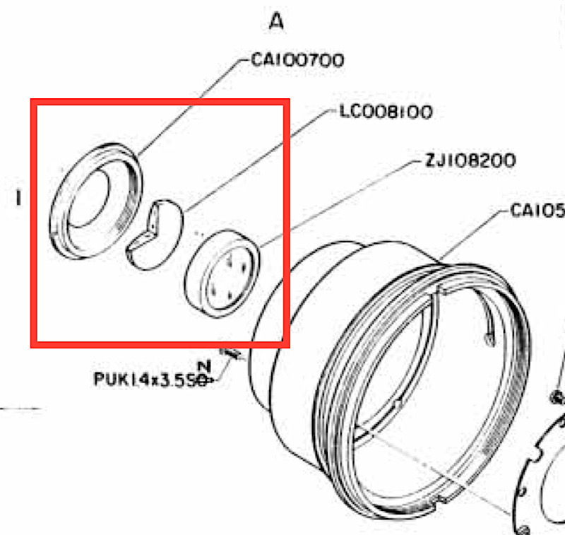

Here is the structure of the OM 28/3.5.
The two rear lenses are therefore easily accessible after removing the rear retaining ring, which has two recesses for the spanner wrench as your photo shows.
If the fungus is on the outside of one of the two lenses and has not yet etched the glass, it should be easy to remove with hydrogen peroxide.
