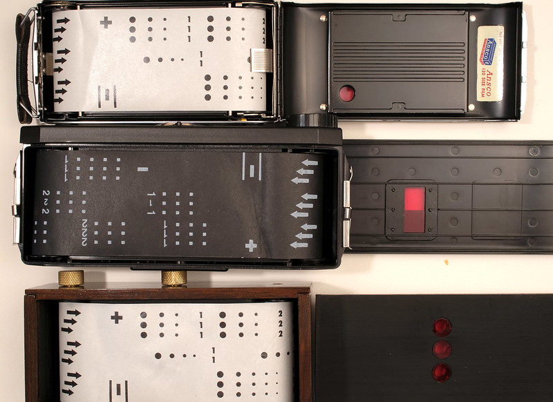

With my RB67, I must keep operational notes to remind me to rotate the film back to the proper position, wind the film, wind the mirror return, and remove the dark slide.
With my 645, 6x6, 6x7, 6x9, and 6x12cm cameras, I must review my notes to determine which red window to use for my frame counter and which frame numbers to use.
For example, on my 6x6cm camera, I must use the middle red window and use frames 1 through 12. However, on my 6x12cm camera, I must use the middle red window and use only frame numbers 1, 3, 5, 7, 9, and 11 to count six 6x12cm shots per roll.
As another example, for my 6x9cm Zero Image camera, I must use the bottom red window to use frames 1 through 8 to count eight 6x9 shots per roll. However, for my 6x9cm Holga, I must use the bottom red window but must only use the odd numbers (1, 3, 5, 7, 9, 11, 13, 15) to count eight 6x9cm shots per roll.
6x9cm Cameras
by Narsuitus, on Flickr
