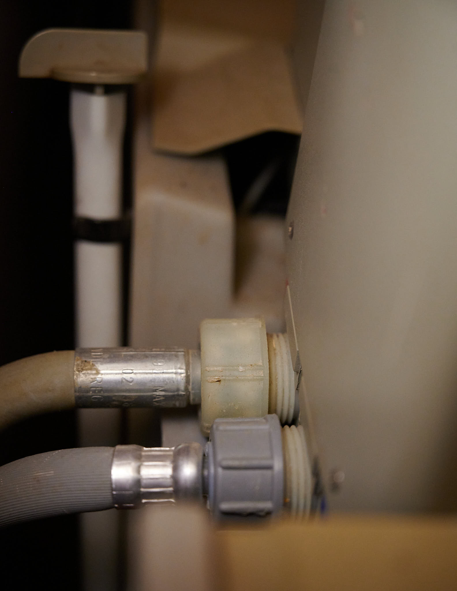

gary mulder
Nov 29, 2006
343
Do you mean these two ? They are BSP 3/4”
Kino
Kino
Jan 20, 2006
7,949
Orange, Virginia
Actually, it is the hose ends (female) that mate to my US spec plumbing where it leaks, but that is good information. Thanks!
