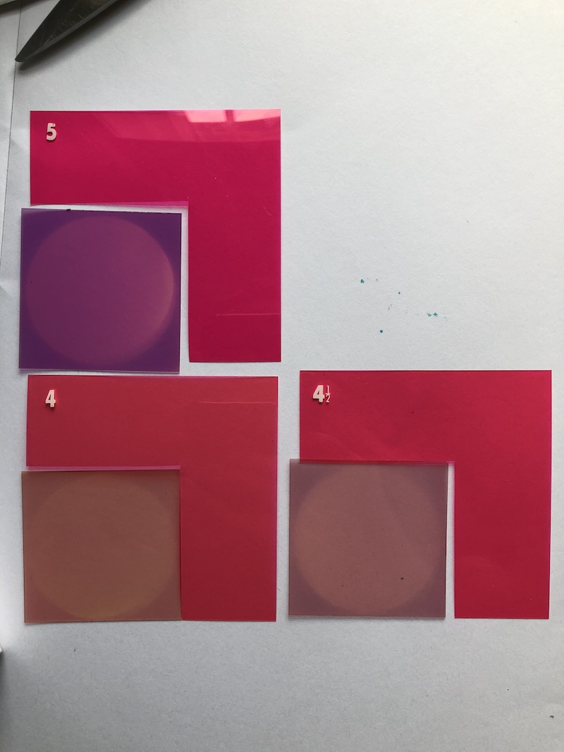

I have 4 sets of filters. The 1st and 3rd are 25+ years old and the others are about 10 years old. I'm scratching my head here, according to the OP the 5's are fading to a darker hue? But the current Ilford number 5's (judging from current catalog photos) look more like my 25 year old filters than my 10-year-old filters. It looks to me like my 25 yr old filters are fine but the newer ones faded.

The filters shown with the circle towards the edge. Probably forgotten to take out of the under-the-lens filter holder.

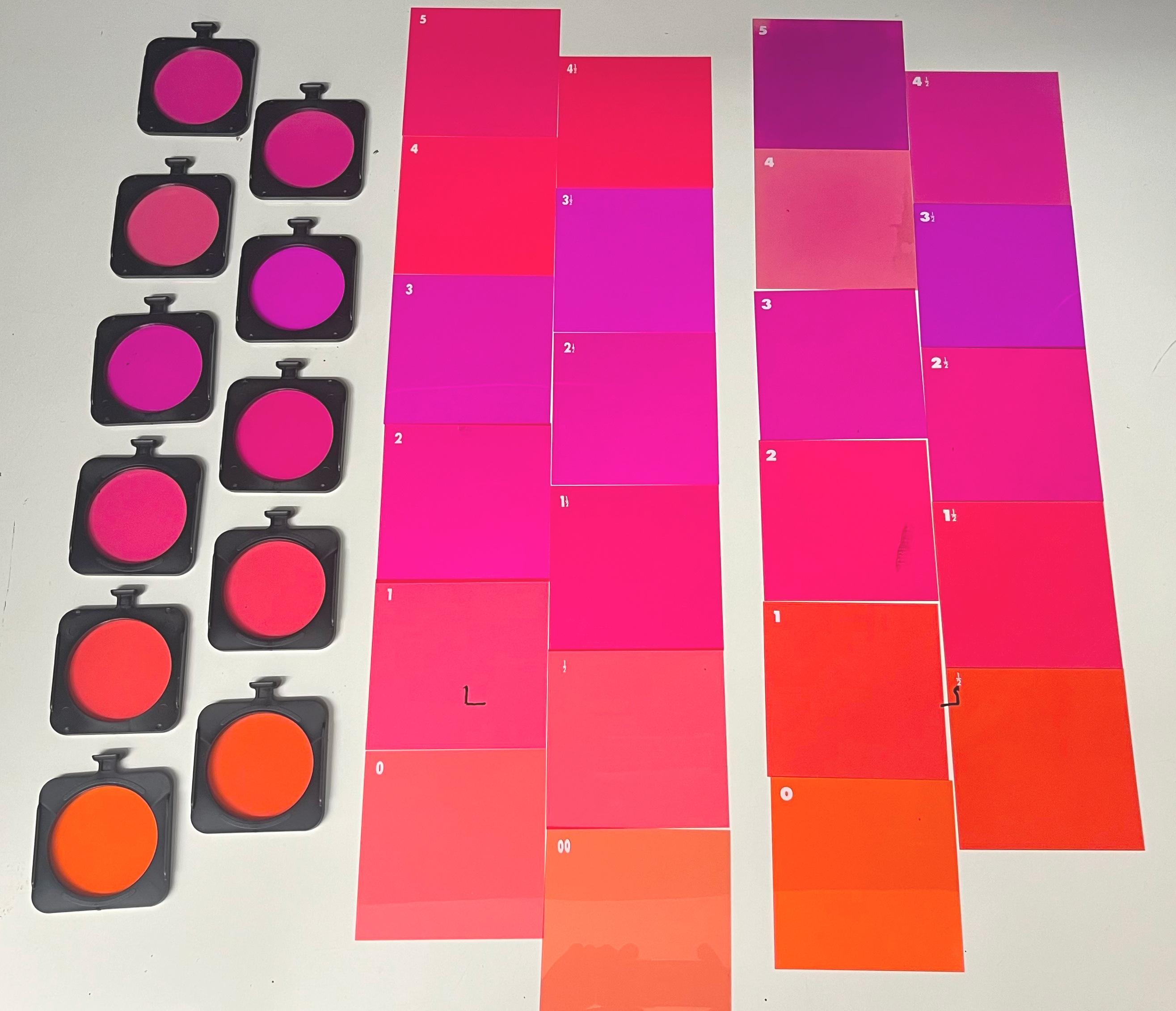

I stumbled on this thread by chance while searching the forum for information on split grading. It made an interesting read as I remembered buying a set of Ilford multigrade filters back in the early 90s’. Around that same time I had the chance to buy a Dichro colour head for my De Vere 203 enlarger, and the box of multigrade filters were put away virtually unused and have stayed safe and warm, hidden away in my darkroom ever since. After reading this thread regarding issues with the filters fading I thought I would find my box and check them. I’ve attached a picture that clearly shows they have faded quite badly, refuting Ilfords claim that they don’t.
Thanks for bumping this, David, because I hadn't seen the thread previously. It inspired me to lay out the 3 sets of MG filters I have. The one on the right is the oldest, from an eBay purchase of darkroom miscellania. The other were bought new, but at least 15 years ago. All have been stored in the dark except when in use.
Like Christopher Saganich in post #33, I'm finding it hard to know what to conclude. The colours seem vaguely consistent throughout the series up to grade 3 1/2, though with evident variation. For harder grades, the colours are all over the place, and quite unlike either the OP's or David's in post #41. Grade 5 in my old set on the right has discolouration at the top where someone has pressed very greasy fingers, but otherwise that is the boldest grade #5 of the three sets. I accept that the OP's old filter set shows evidence of fading, but each of the three top grades of his new set is unlike mine in different ways.
I can't comment on the current performance of mine because I almost never need anything harder than grade 3. Most of the time I work with the below-lens set on the left, and switch to the above-lens set in the centre if I'm being totally perfectionist (almost never!). I have never used the set on the right. Clearly I must get myself a printing step wedge to run some simple tests. But I can't help wondering how much of the variation is just down to manufacturing?

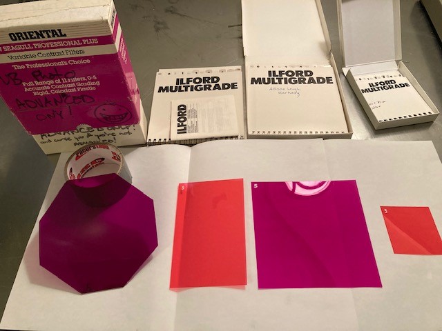

Thank you David and Snusmumriken, for those photos!
I just looked at my set, bought "used" (but seemingly unused) years ago. And stored dark since then. In a full-stop row of six it looks as being inbetween your samples, with #4 being the odd one.
Another filter of the set has extreme fading just at part of its circumference and a few blotches of fading, all resembling quite good lens seperation, to give you an idea.
