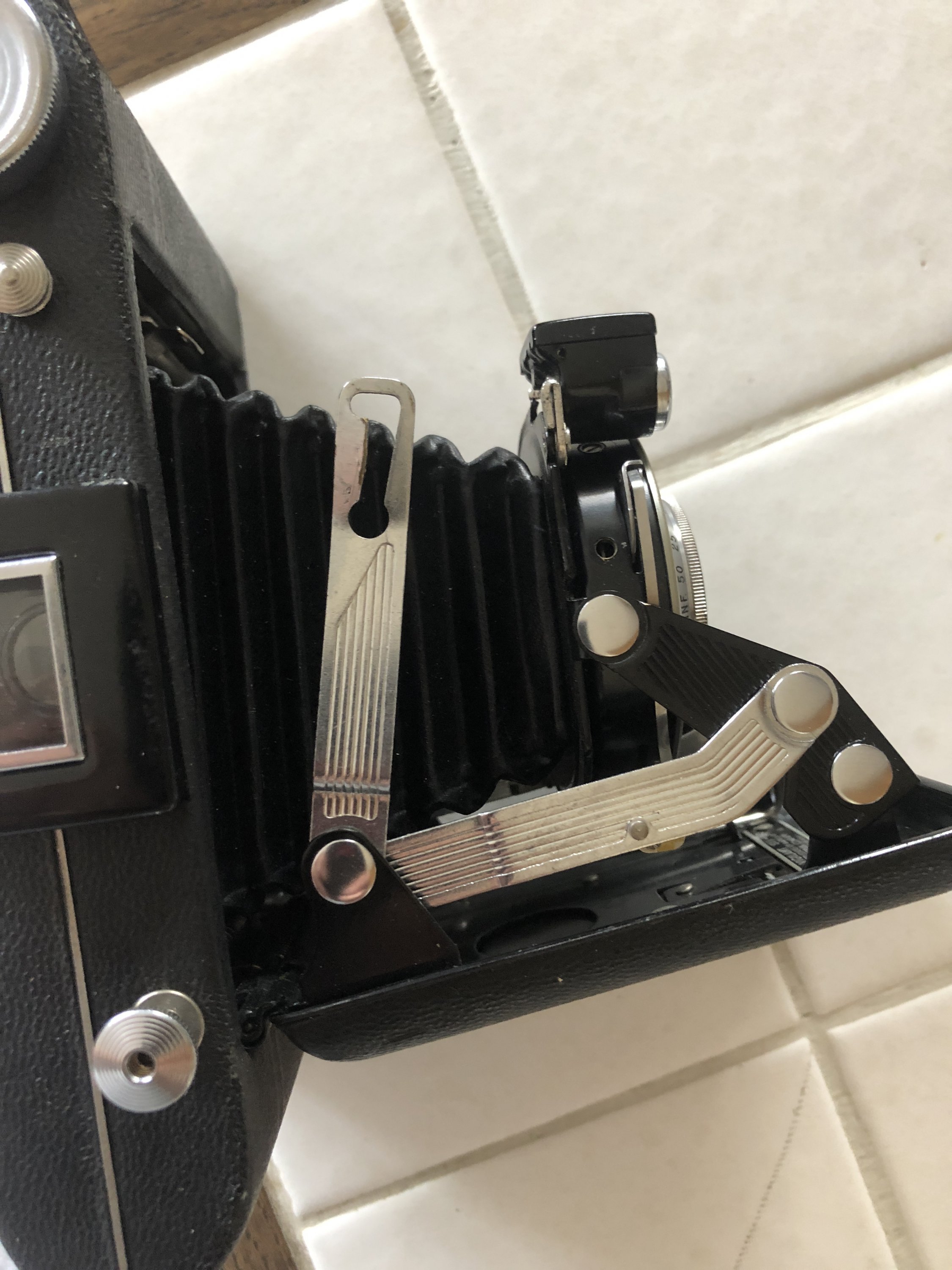

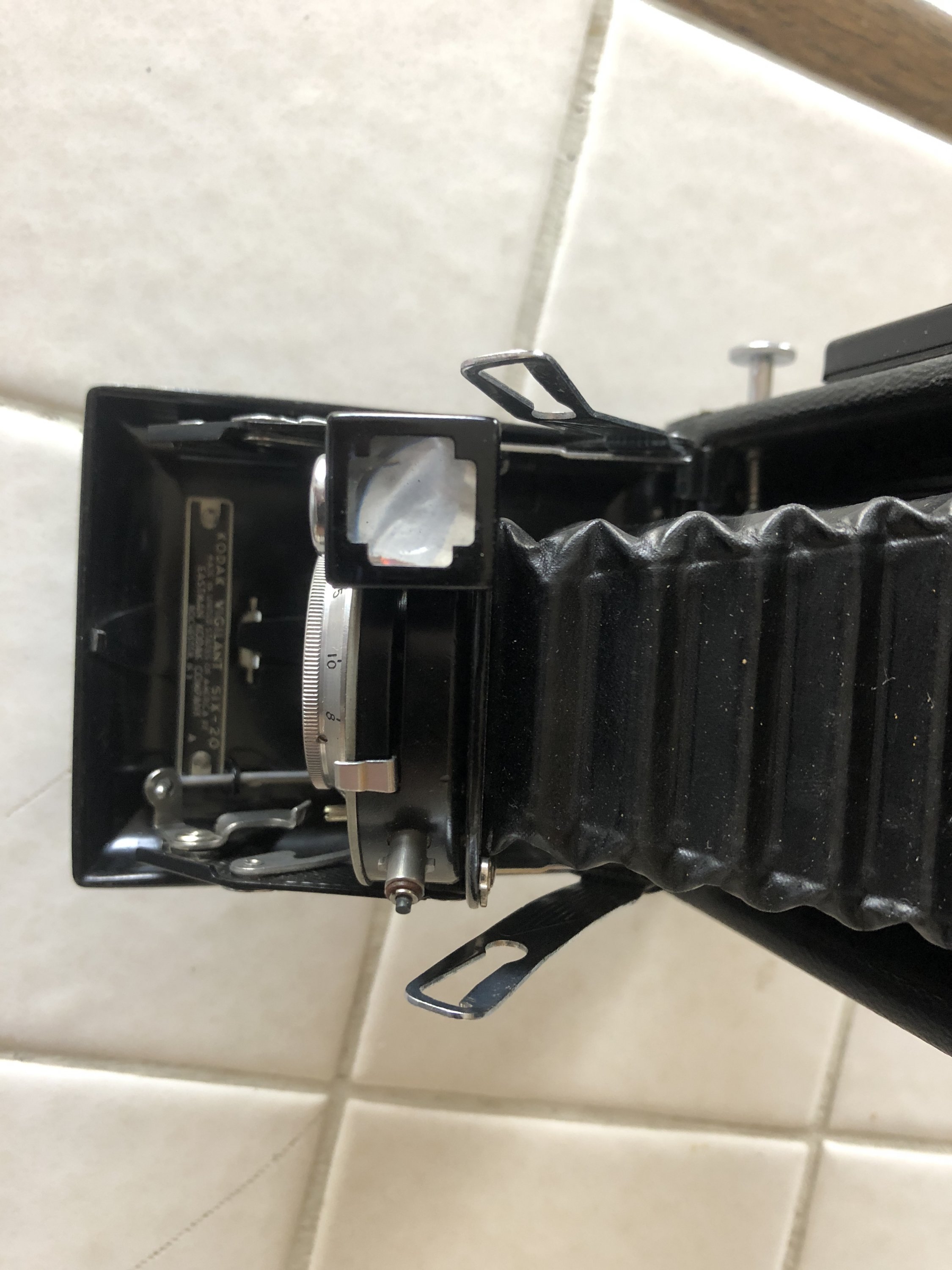

Attached are the images of the slider/rails that have detached from the camera. Also, the shutter is assembly is disconnected and the camera doesn’t close all the way.
For follow on information, these are cameras that my grandfather had. My dad inherited them and my brother had them on display not being used. Here in the coming weeks, I will retire from the Navy and these cameras were a gift to me as I have a greater interest in photography than he does. The Brownies are very rough. The Hawkeye and Vigilant are in better condition and have greater potential to be restored.

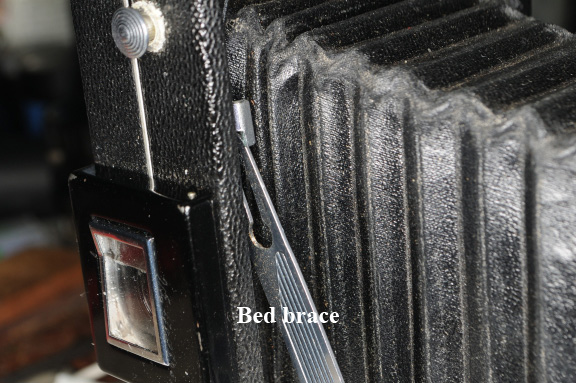

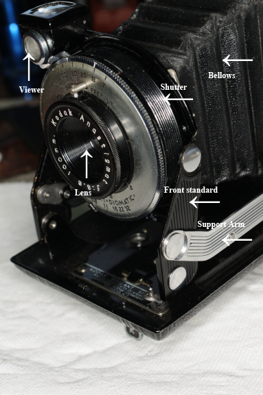

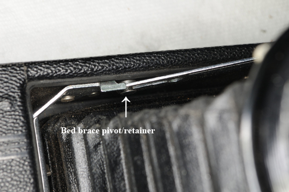

Pictures with standard camera terms:
The bed is the part the front standard is riveted to.
The bed braces have been disconnected from their pivots/retainers.
Are the heads on the retainers? The braces should not come loose from the body and as they are bent outward they may have been pried off.
I don't know of anyone that will service this camera as most have retired.
