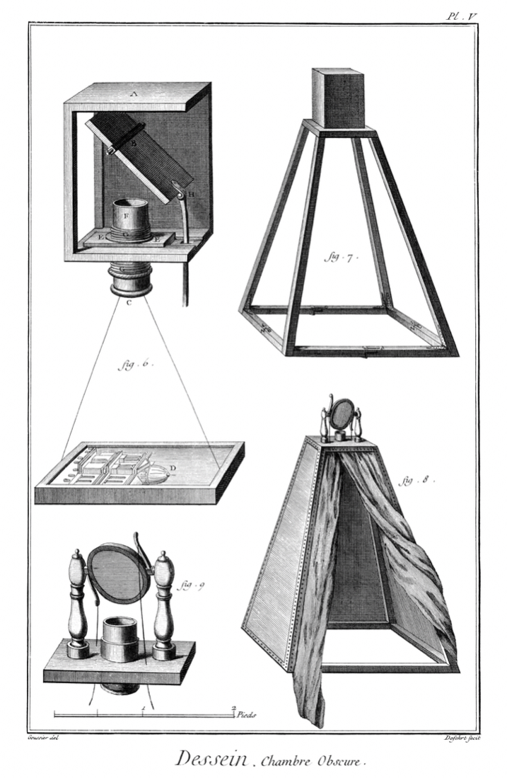

Old-timey camera obscura
Other side
Other side
Portal
Portal

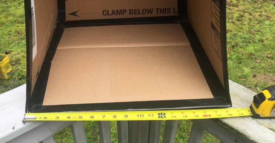

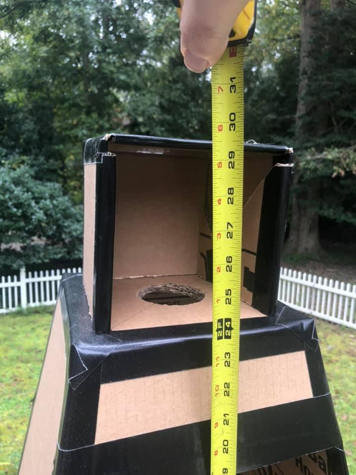

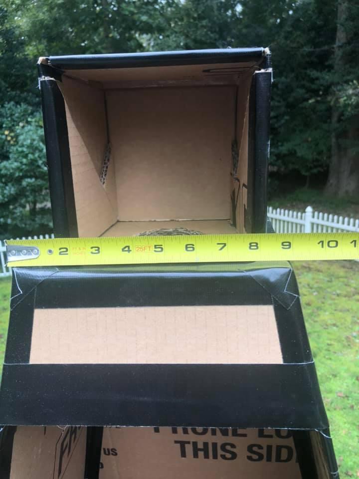

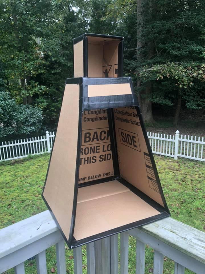

Good morning-
I’m hoping to find some advice. I wish to build an 18th century style camera obscura. I’ve made a prototype, but not knowing much about optics, I need help identifying and obtaining the right lens. I’d appreciate any assistance.
-Bill

For drawing? I'd start with the image size you want, then work backward to a focal length for the lens. Maybe a little shorter lens than the diagonal of the image size for general views or environmental portraits, and probably about the diagonal or a touch longer for closer portraits.
Do you want authentic, or simply functional. Lenses would have been very simple at the time and somebody here can probably offer advice on sourcing something from a supply house. Or just any lens that comes up from the photographic era will work even better. Your are probably into focal lengths that aren't pocket change, but still lots of funky stuff out there that is cheap.
Given the size of your enclosure (assuming I'm judging correctly by the manufacturer's printing on the waferboard) a lens from an old overhead projector (and its accompanying mirror!) seems just right. These lenses usually have a focal length around 300-450 mm at infinity focus, and tend to be quite fast. They're not really sharp enough for most folks to put images on film that will be enlarged, and they have some distortion and aberrations, but they should be quite good enough for a camera obscura like this, where image brightness is the biggest thing to make it easy to see.
And because they don't have much other use, plus overhead projectors having been almost entirely replaced with big screen TVs that can do many other things besides display from transparencies, a used or surplus projector is likely to go pretty cheaply.

From a practical viewpoint, I'd approach this the other way around. Get your hands on some lenses and then figure out the dimensions to make a useful camera obscura. You'll face a tradeoff between brightness of the projected image, size of the projected image and angle of view.

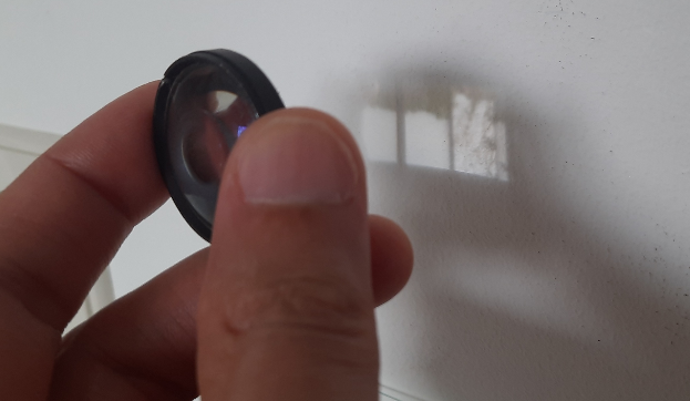

Btw, you can fairly easily get a feeling for what a lens will do by holding it at a distance from a flat, white wall that faces a brightly lit window. The lens will project a somewhat dim image that gives an impression of focal length.

Other than that, you likely need a lens that has focal length at least the diagonal of your piece of paper/viewing surface (shorter focal lengths likely have objectionable light falloff and aberrations at the corners), and as fast (large aperture) as you can get. The box needs to put the lens one focal length away from the paper and have some way of adjusting the length by a small amount (say 1/10 the focal length) to focus.
A simple meniscus or plano-convex lens may work. One source of meniscus lenses is photographic close-up filters. A +3 close-up has focal length about 333mm (13") which may be about right. If you get one in 62mm thread size, say, then it should have clear aperture of almost 60mm so f/5.5 ... not too bad but even faster would be nice. A +2 close-up has focal length 500mm if you want to make a larger camera obscura.
