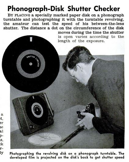

I have been looking for a physical copy of one of these for a while, just for fun.
However, the principals for this and using a CRT based TV for shutter testing is outlined here by Andrew Davidhazy of RIT;
https://people.rit.edu/andpph/text-calibrating-shutters.html
Should be simple to make your own disk, just make sure your turntable is accurate. I've been meaning to try this as well, I'll probably just put some white tape on an old record. Is there a reference for the angle or distance the mark moves if the turntable is running at 33rpm?
An important lesson to remember based on a friend's attempt to test one of their old cameras this way:
Remember to use continuous lighting, and to not spend a roll accidentally confirming that the camera's flash is working fine... :tongue:
Also helps if you're using a turntable that is actually reliable and steady speed. Doesn't take much flutter to muddy the results.
It wouldn't be much use on a 33 rpm turntable. 33 rpm = .55 rev/sec. 1/125 sec equates to 1.58 degrees of rotation. It becomes a bit more practical at 78 rpm, but is still pretty much limited to 1/125 sec.

The turntable was the other way and it’s limited practically (at 78.26 rpm) to a range from 1/25 to 1/5 second.
Take a picture of a falling object against a ruler! Objects fall at a constant acceleration of g=9.8m/(s^2). The time is calculated as t=sqrt(2d/g). You can see the distance the object has traveled in the exposure. As long as the object hasn't reached terminal velocity, and you're relatively close to sea level, it should produce an accurate enough answer for a photographer's needs. Just make sure to zoom in enough to get an accurate measurement.
Try this in practice. There are two problems: first the equation you give is only correct if the object starts from zero velocity, so you need to time the object release much more precisely than the shutter. Second, the distance goes as t^2, which means it is very sensitive to time differences but only works over a small range of times, for ex in 1 second a dropped object falls 4.9 meters, but in 1/60 second it falls 1.4 mm, which would be hard to measure accurately.
With the phonograph record the angular velocity is constant, which makes the method have a hope of working. Many turntables have a stroboscopic pattern printed around the outside, so you can adjust the speed precisely using the flicker of a lamp at the 50 or 60 Hz AC frequency.

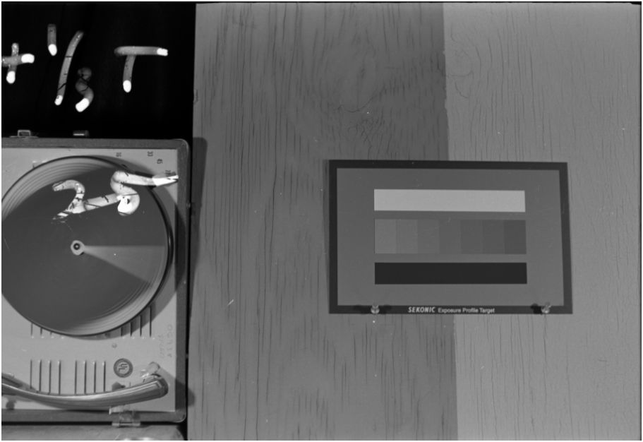

I scanned the negatives and used Photoshop to measure the angle.
Above 1/25th second the angle was just too hard to measure so I considered it unreliable as an indication of speed.
That looks a lot like the article I followed.
From 1/5 second to a second I took my readings from the electronic timer. The turntable would still be good for a quarter or half second but the electronic timer is fine in that range.
