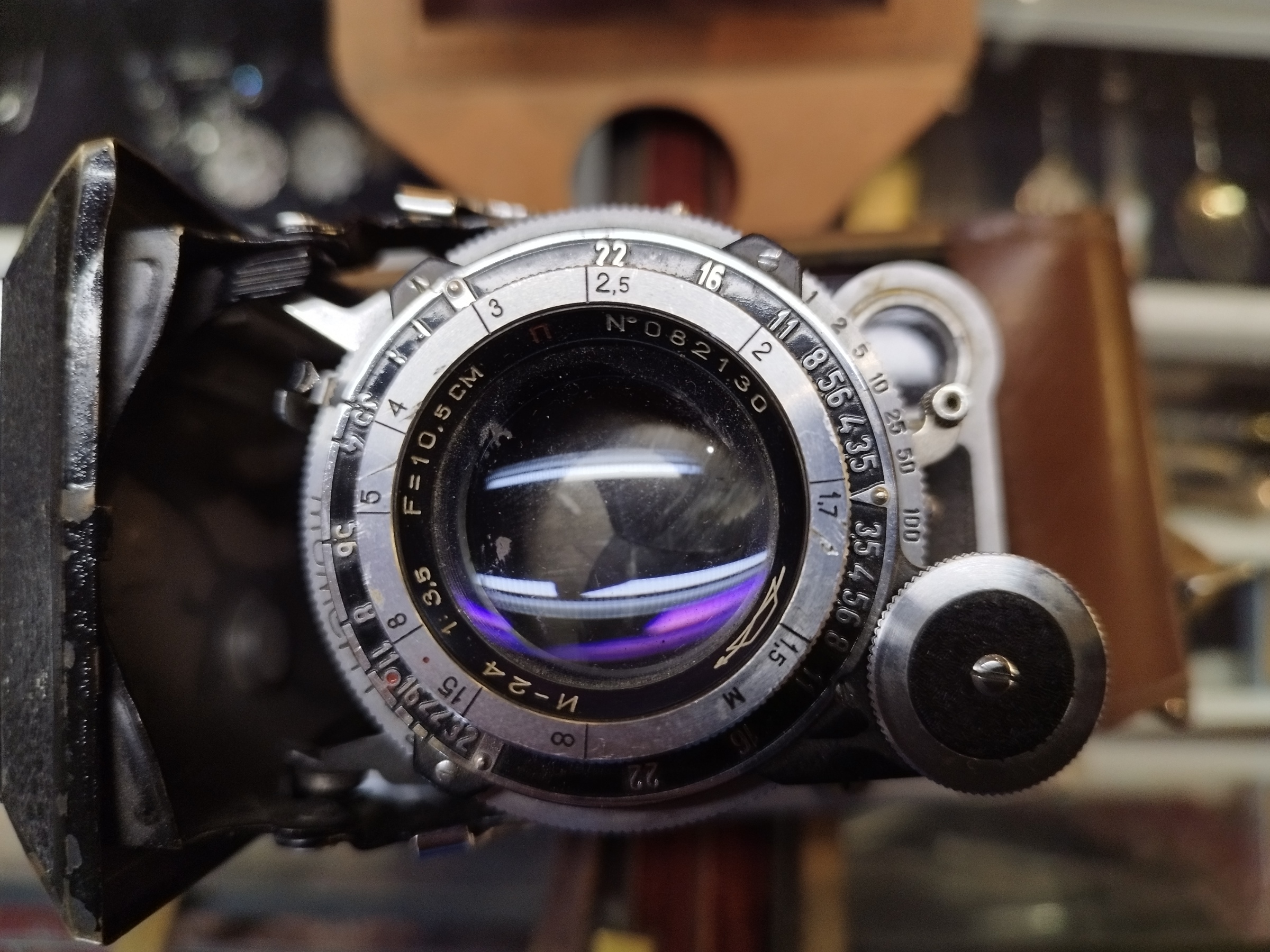

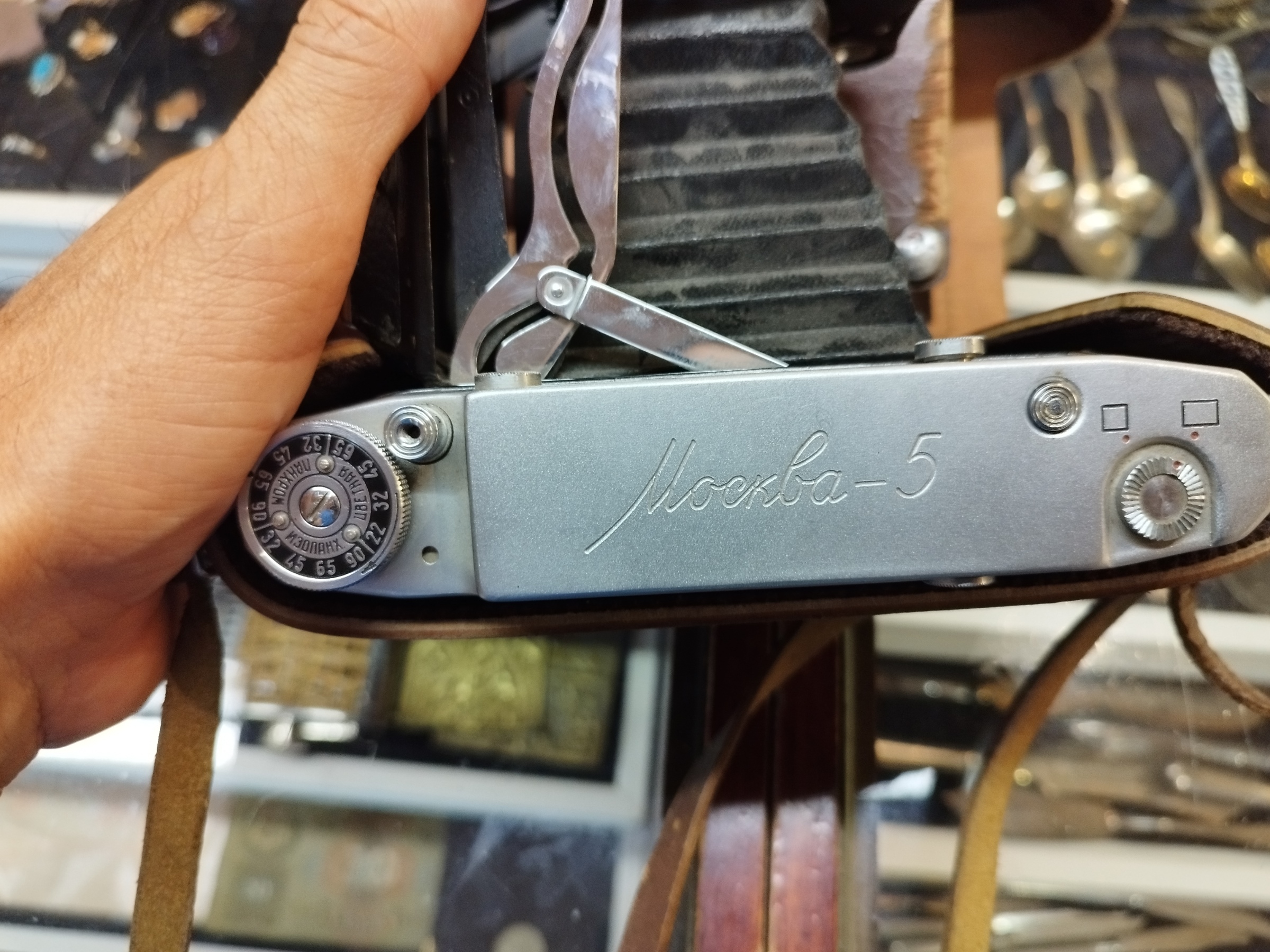

I've found this camera in a vintage shop in Estonia. Do you think it's worth buying it? The lady wants 120€ which is a lot of money for me. I would buy it only if the camera is something special... Is it?
Thank you very much.

It's a Moskva (Moscow) 5 the last in a series of cameras from 1946 to 1960. What it's worth depends on its cosmetic and mechanical condition. It's basically a copy of the Zeiss Ikonta. Asking prices run from $50 to $500. What it's "worth" is another story.
The Moskva cameras are copies (but not exact copies) of Ikontas and Super Ikontas:
http://camera-wiki.org/wiki/Moskva (overview of the whole series), and
It's a coupled RF for 6x9, which some people would consider special; and it should also do square format if you have the extra mask for that.
I'd want to be confident that the shutter and the RF are working, and the lens is in good condition, for that sort of money.
That lens is an Industar-24; Industars are all Tessar types.

I've owned two Moskva 5 examples (regretted trading the first, so bought another a couple years ago). Both have been very good. If the bellows and shutter are good, rangefinder accurately calibrated, and shutter runs correctly, it's a very good camera -- more so if it has the 6x6 format mask with it (there are several versions of these masks, and I'm not certain if they interchange between cameras of different ages). In some ways, it's better than the Super Ikonta C it was originally based on (the Moskva 5 is an upgraded version of the original Moskva 3 that was an exact copy of the Zeiss, made on Zeiss equipment taken as war reparations).
on ebay the prices of these range for $80 up to about $300 (USD), depending on condition. eBay may not ben the most useful pricing source to compare to local sales, but it suggests the the price is in the ballpark, and if everything works well it may, at 120 eur, but a reasonable deal.

Also, if it hasn't got the 6x6 mask, it's worth a bit less. Open it up, hold it up to the light with the bellows extended, and look for obvious light leaks (though the Moskva 5 isn't really prone to these; whatever they used for the bellows covering seems pretty durable). Make sure the RF at least moves with the lens focus (it's hard to check exact calibration without shooting a roll, but if it move right, chances are it's good). Check that the lens is clear of fungus and the shutter works and is close to correct on the slow speeds (don't try the self-timer, though, they're hazardous even if the camera is otherwise fine).
To me, $120 (which is a bit less than 120 Euro) seems a reasonable price in today's market for a Moskva 5 in good shape.
Agree on the $120 if it is on good shape (no problems with lens, no light leaks, working rangefinder, straight/stable struts, etc.) Moskva 5 is a fine camera, capable of producing great images. If you need the negative size, one of the best and smallest options.

See if there is a return policy. One problem with some folders is that they can get out of alignment, resulting in pictures that are in focus on one side but not the other. You may not be able to notice that without trying it.
Truth.
A trial period long enough to shoot and process at least one roll (use the widest aperture practical, to show up focus errors) with return/refund ability would be ideal, but a secondhand dealer likely doesn't have any such thing.
That said, a camera that's in good cosmetic condition with an accurate shutter is somewhat less likely to have this kind of damage...
