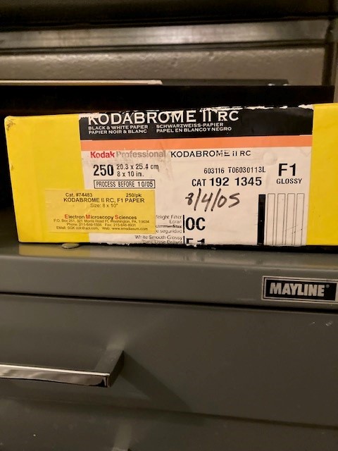

I found a box of this last week being discarded from an electron microscope lab, maybe from 2005, so not that old! Is F1 high contrast or low contrast??
