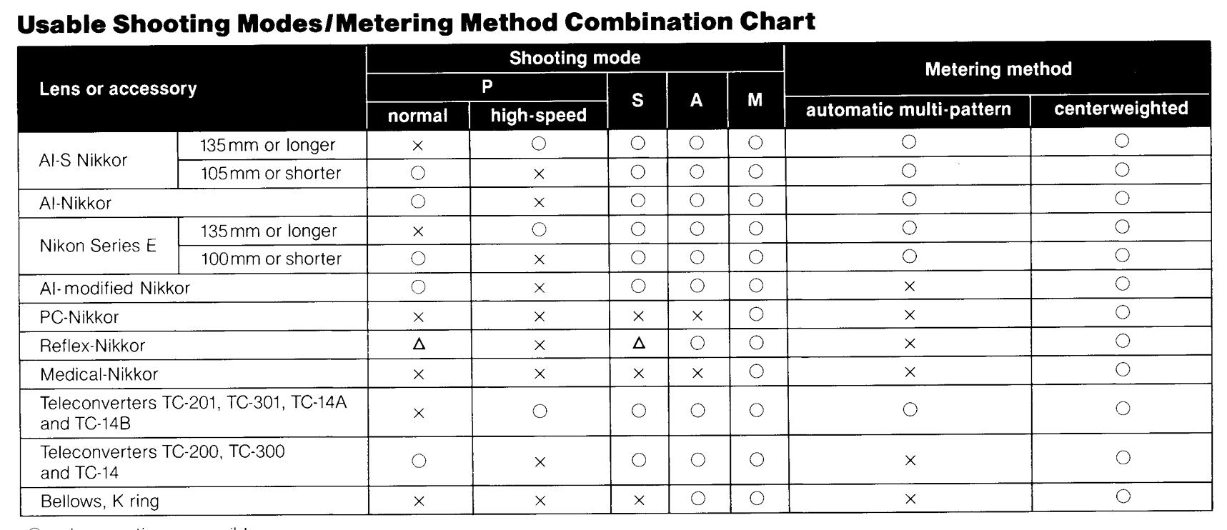

Yes, the AiS lenses are needed for the FA's Shutter-priority and Program modes. Some criticize the FA's implementation of these modes, since it introduces a substantial shutter-delay (the body will stop the lens down and then re-measure the exposure before actually exposing the shot).
Long time FA owner here. As the chart from the Nikon FA manual below shows, Shutter-Priority and Program modes are available with AI and AI-converted lenses as well:
When the FA senses that a non-AI-s lens is in use in S and P modes, it uses the TTL sensor to take a final "mirror-up" exposure reading and adjusts the shutter speed accordingly. So while it functions, accuracy suffers. In the ~40 years I've had the FA, I've also had a 50mm f/1.8 AI which I never bother to "upgrade" to AI-s.
I stand corrected: This chart indicates that the AiS lens standard is only required for what Nikon calls "high-speed P-mode". Essentially avoiding the exposure-delay of taking a final mirror-up reading as you say. I never used a non-AiS lens on my WIfe's FA, so never experienced the exposure-delay older lenses would impose (and frankly avoided P-mode almost entirely as I preferred the A-mode from my FE/FE2, or else just manual exposure). Internet reviews of the FA often call out this exposure-delay, but it would seem that it only happened with non-AiS lenses.
I will still say that the FA, F4, and F301/501 were the only bodies with the full set of AiS-mount mechanical interface levers. Obviously, as Nikon didn't bother including it in later bodies, the advantages were not that significant (or even noticeable by users), so AiS was kind of a white-elephant technology in some ways.

While the F4 had it, since it only allowed use of non-CPU lenses in M and A modes, I'll be damned if I know what it did with that data.
I didn't realize that aspect of the F4: That seems very weird! The two main AiS features (linear aperture stop-down and a telephoto focal-length indicator) would seem useless for M and A mode. The only possible use I can think of is some sort of interaction with the matrix flash technology where knowing that you have a telephoto lens might be a part of the computations to optimize the flash settings.
