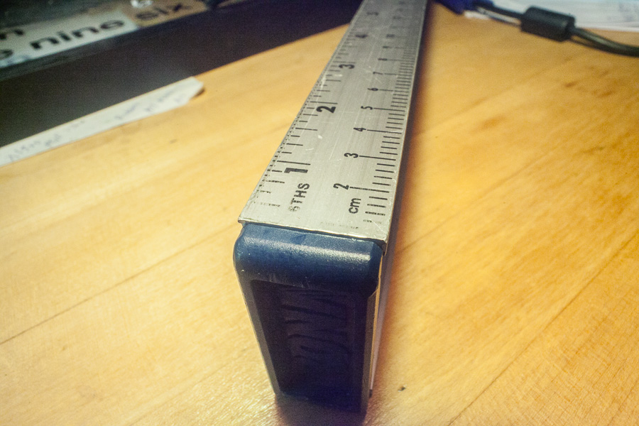

The barrel says something of 12cm or 13cm and this your focusing test shows too. Thus about 5 times what of you said above.

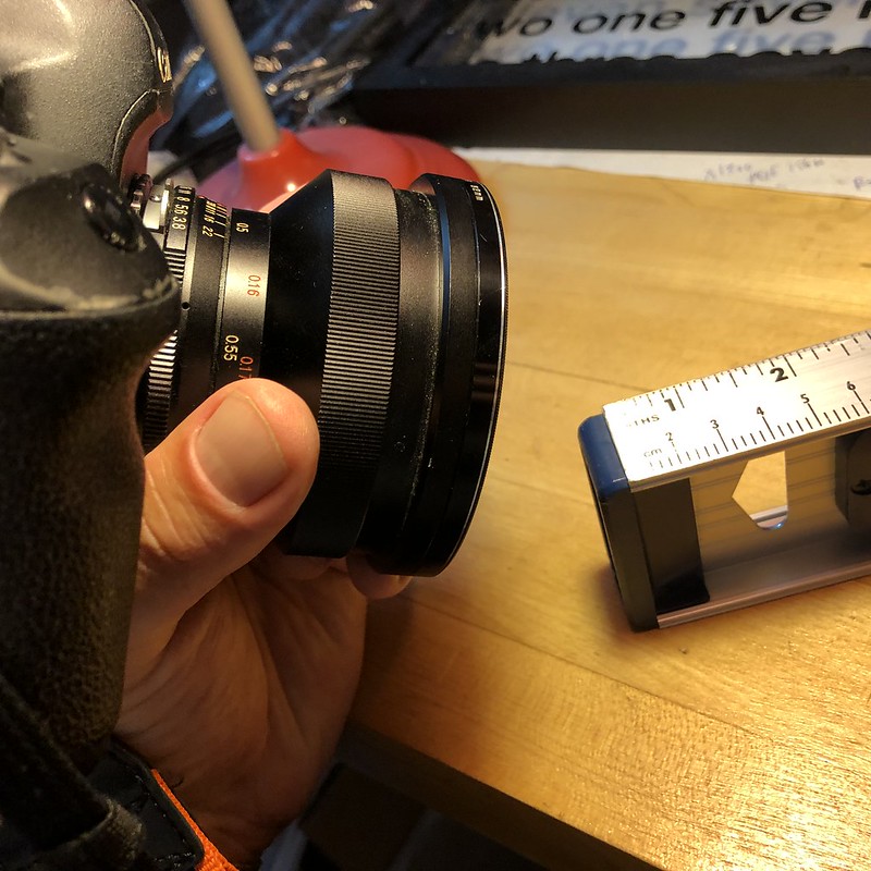

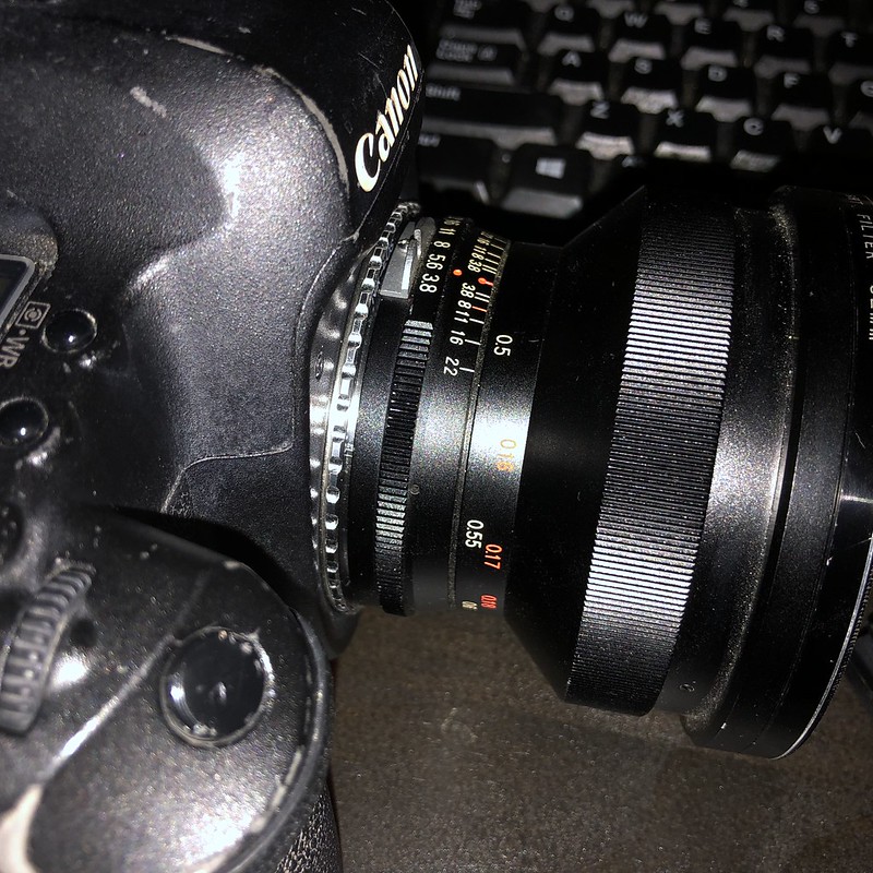

Focus goes much closer than .15 mark. Pass the .15 mark. I don't know how else to write it in English.
I provided close focus image for you and image how close lens to the focus point was.

You mix up uses of the the term focusing distance:
-) in general this term is used for the distance object - focal plane
so is the case with nearly all lens barrel markings, for sure with all SLR-lenses
-) in few cases the term refers to the distance object - front of the lens, as in use of close-up lenses screwed onto the primary lens
(In cases as extreme wide angle lenses, fish-eye lenses the stated focusing distance may mean that an object sitting on the front lens is still sharp.)

Thread is called "surprising close focus". The lens I have shown is known exactly for this. Its minimal focus distance is about three cm. Lens focus barrel rotation does physically supports it. It goes well pass 15 cm. Means it is focusing pass 15 cm, closer, at 3 cm.
You could see on the pictures.
I could see it in VF as well. @f3.8 DOF is few cm. At 3 cm MFD. If I make aperture f8, DOF is increasing to something like 15 cm. Very impressive DOF at 3 cm focus distance. Because it is UWA lens.

If the distance between the object to front of lens is 3cm, and the distance from front of lens to sensor/film is another 10-12 cm, then the focus distance is somewhere between 13-15 cm, consistent with the barrel reading. All AgX is saying is focus distance as marked on lens barrels is calibrated as the distance from the object focused on to the sensor/film plane.
Something rings the bell for me:smile:
I was stupidly metering focus distance from lens front, while it as you mentioned, from this mark many cameras have on the body.
