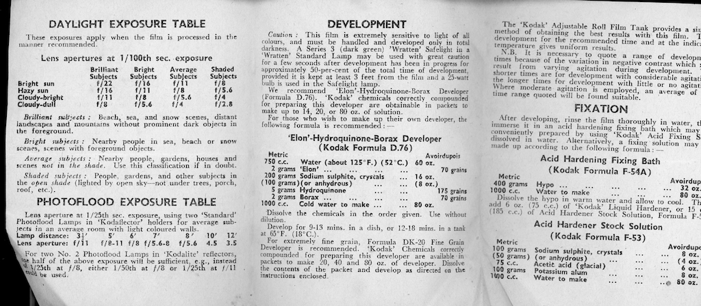

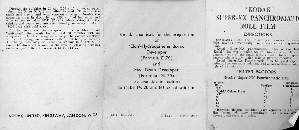

Packing up a couple of shelves of developing tanks for the big move, I came across this little tri-fold pamphlet in an old box. Since Double-X has a new life, it might be of interest.
As I recall, this is not the same as the cine 5222 (and other numbers for other formats) that we get now as Double-X.
I think Donald is right on this. I remember reading years ago that Super-XX and Double-XX are definitely different emulsions. It is a cool little tri-fold though.
