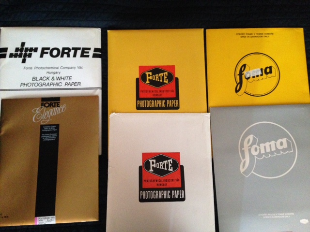

And finally the little stash of mine from Forte paper. What you see on the bottom left is what I have 1000s of sheets - didn't put it all on the table.
Problem is I don't have big paper much.
Since you asked about Japanese paper - no I haven't tried the old exotic ones yet but I do currently use Fuji's AM line which is RC paper non gloss. I buy the 110.5cm X 20m roll and cut whatever I need.
It's the cheapest in Japan and still available. The biggest print I've done to this day was 90x90cm, basically a meter by meter sheet of paper wall mounted. Lot's of fun and hassle at the same time as I can't process over 20x24" in my darkroom so I need to take it over to the bathroom after exposure and develop on the ground with sponges. Anyways more on that later.
