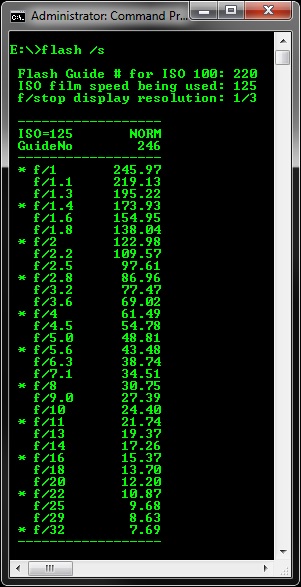

If you should reach the stage of actually trying them out, you might take a peek at a simple little Windows-based command line utility I uploaded to the Articles section here a while back. It's something I've used for years to generate flash-to-subject distance tables for various flashbulbs and electronic flashes when used manually.
Like APUG in general, it's a little bit arcane. Just a simple character-based interface. But that's all that is really needed. I simply print the tables out and stick 'em on the backs of my antique cameras and flashbulb attachments for reference.
Here is a sample run for a GN 220 flashbulb, used with Ilford FP4+ at box speed, and broken out to a resolution of 1/3-stops. Because the GN is expressed in feet, the distances in the table are also in feet:
(There is a major upgrade coming soon, as I have added a significant number of new things from my ongoing wish list...)
