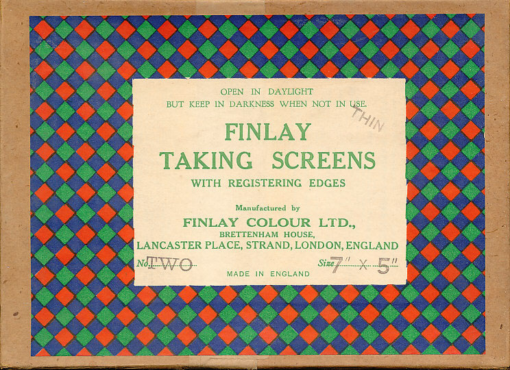

Given the location of the OP, a couple of lesser-known UK color processes to add to the mix.
First, Finlay Colour, from the late 1920s and early 30s, which placed an RGB filter over a B+W plate. Interestingly, this scheme well-predates but remarkably resembles the filter developed by Bruce Bayer at Kodak. My dad was stationed in the UK during WW2 and came home with a stack of these filters, although he didn't own a 5x7 camera and I don't have any negatives or prints that used this process.

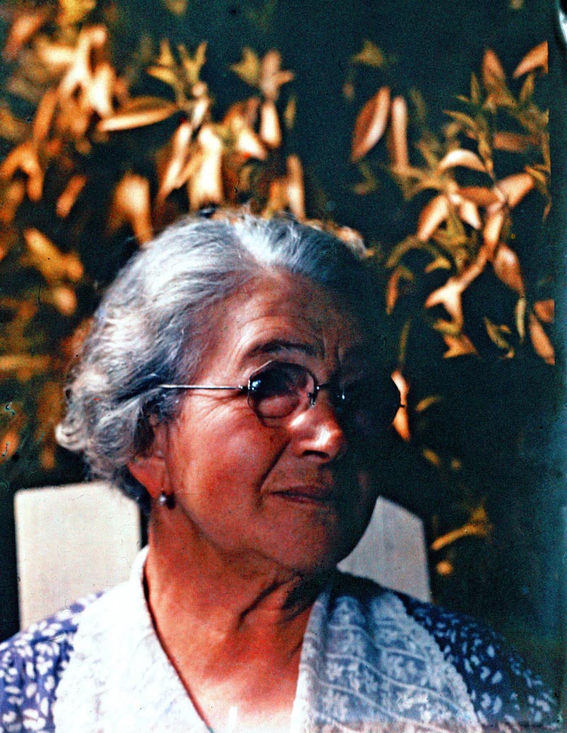

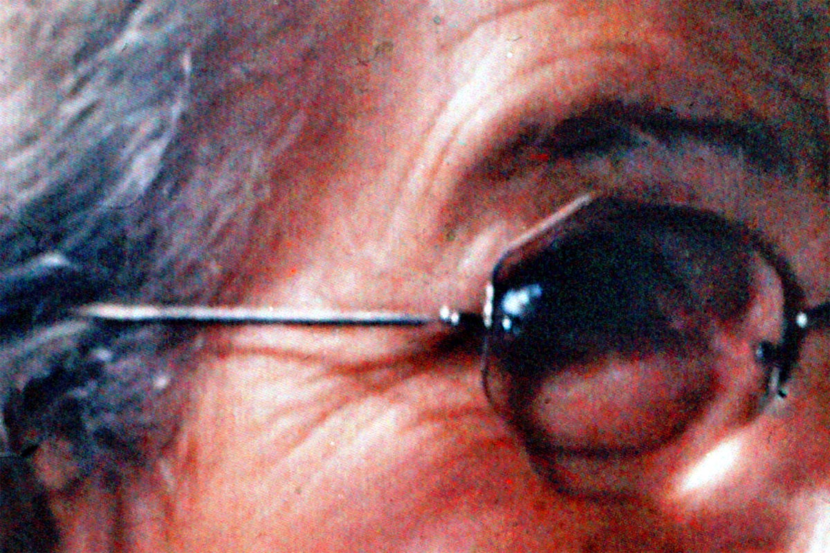

Second, Dufaycolor was an additive-color process, similar to the later Polavision motion picture and slide films. My dad apparently shot a roll or two after WW2, as I have an image of his grandmother on a Dufay slide. Full image scan and a 100-percent scan below.

@EarlJam thanks for these - I saw the Dufaycolor on the website @Ian Grant suggested, and I really like the look of this process.
