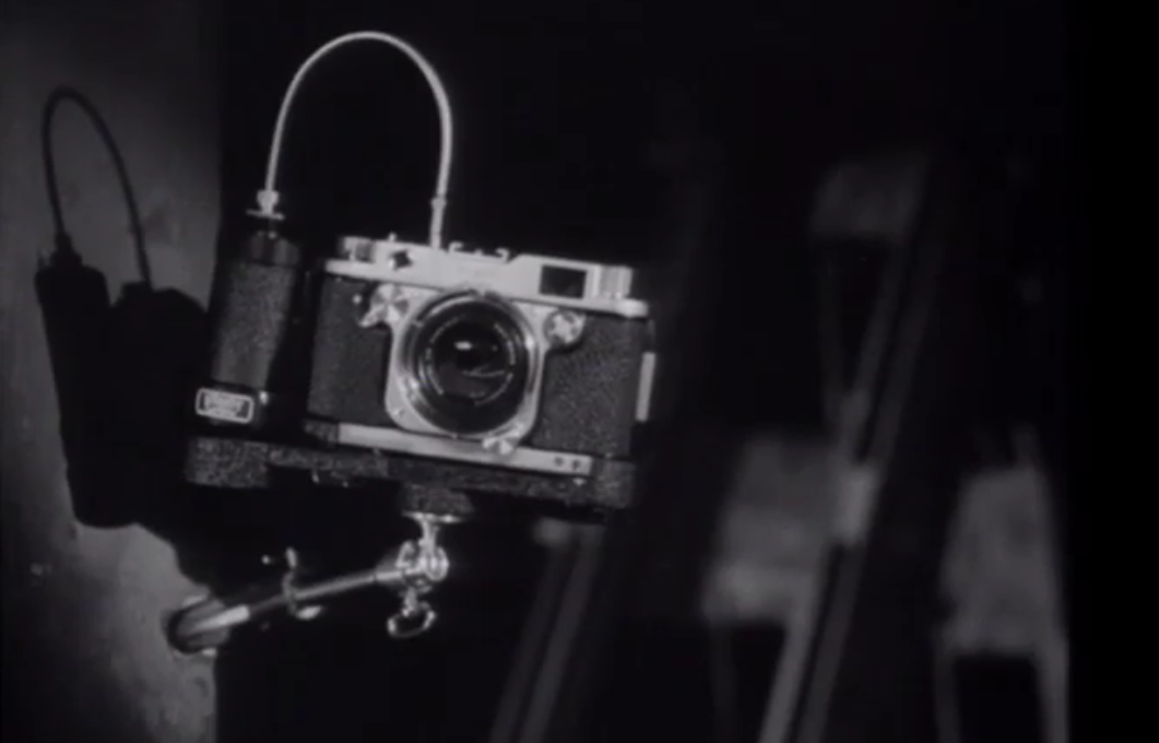

Linhof Super Technika 9x12 w. Universal-Finder w. Polaroid back
(in same scene also a Linhof Super Technika 6x9 Press, Pentacon Fs, Land camera etc.)

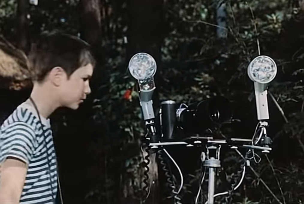

Pentacon F
with: Sonnar, motor drive, magnetic release, radio remote control, 2 flashes
For bird-photography by east-german electronics scientist and amateur photographer.

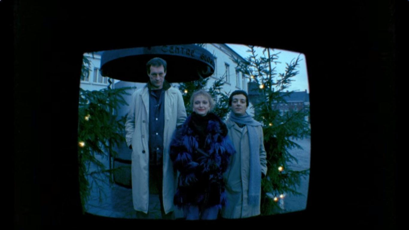

Viewfinder view:
Unidentified camera and rangefinder
"De Vijanden" (The Enemies) , war-drama , Belgium/Netherlands ,1968
setting: Belgium 1944 , Battle of the Bulge; a US-senator sporting and using this camera when visiting the front-line
GOMZ Sputnik 1
sported by an background actor
Soviet TV music show consisting out of scenes filmed in open air , 1969

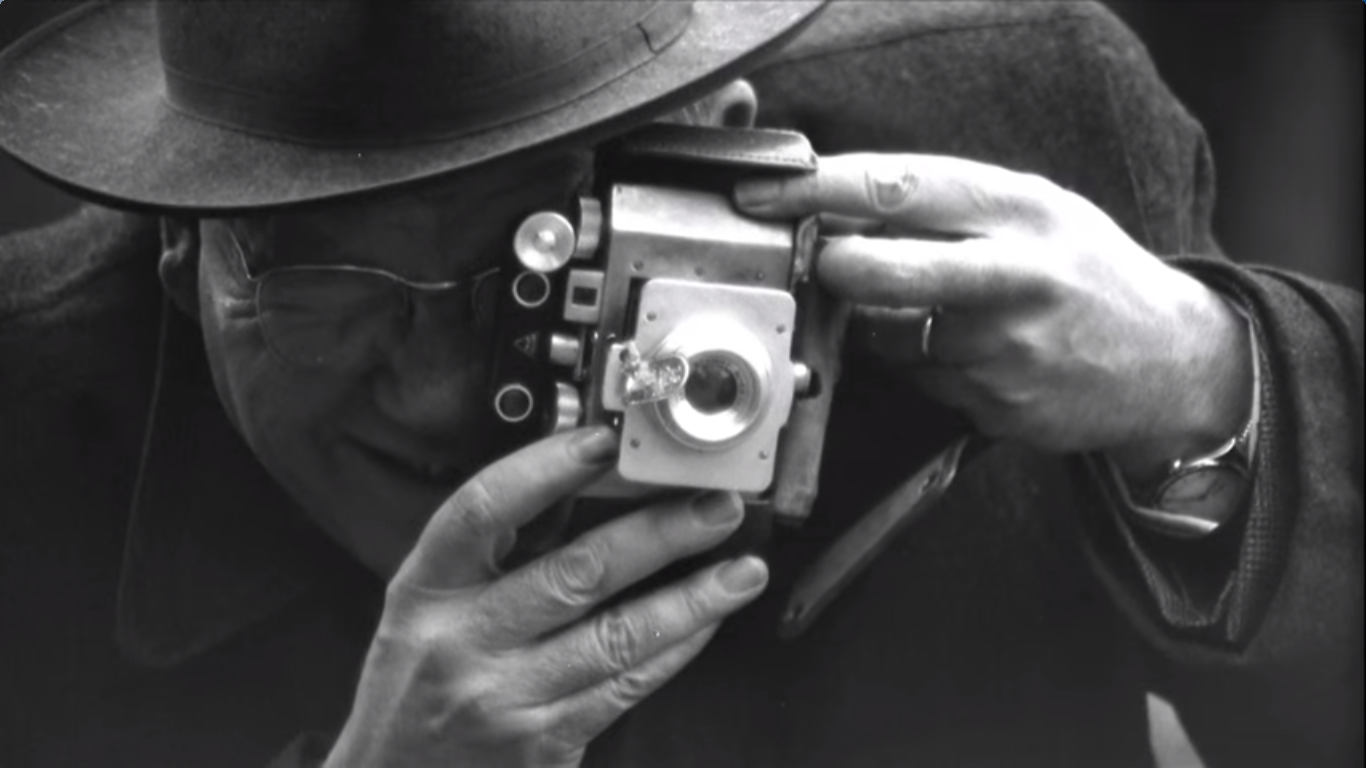

The camera is in a misfitting case, based on the visible front frame of the actual viewfinder, it's probably a half-frame, either 35mm half frame (that was the common format before the Leica I came out in 1930) or 127 half frame, but probably 35 mm based on the rewind knob; the rangefinder is uncoupled and appears to be a shoe-mount type (not part of the camera).
And I found it (after looking through hundreds of images on Pinterest): It's a Gallus Derlux, the half-frame version of the Gallus Derby (which was based on the Foth Derby). It's 127 half frame (16 on a roll, same size as an 828 frame, 28x40 mm), the mounted accessory RF is a Gallus unit as well. What looks like a rewind is the film advance (photographer's right to left); the knob next to the shoe with the RF mounted is the shutter speed control; this camera had a side-moving focal plane shutter.
Donald, you are great!
I merely heard of the manufacturer Foth, and for sure never of the manufacturer Gallus. But a french manufacturer is not that surprising in a belgian production. Whether that camera is apt for a US senator... and whether such ever visited that frontline... (script and directing by the most laureated dutch author)
I wonder what kind of tag is hanging from the front standard.
It's a dog tag. Soldiers weren't the only ones to wear them. A dog tag on a camera meant the powers that be knew you had it and were authorized to use it; get caught taking pictures without one, and someone was likely to ask a bunch of hard questions, on the presumption that you might be a spy.
Yes, to me it looked like a "dog-tag" too, but it made no sense at all to me. Thank you for explaining.
Thus the props were good on this point...
