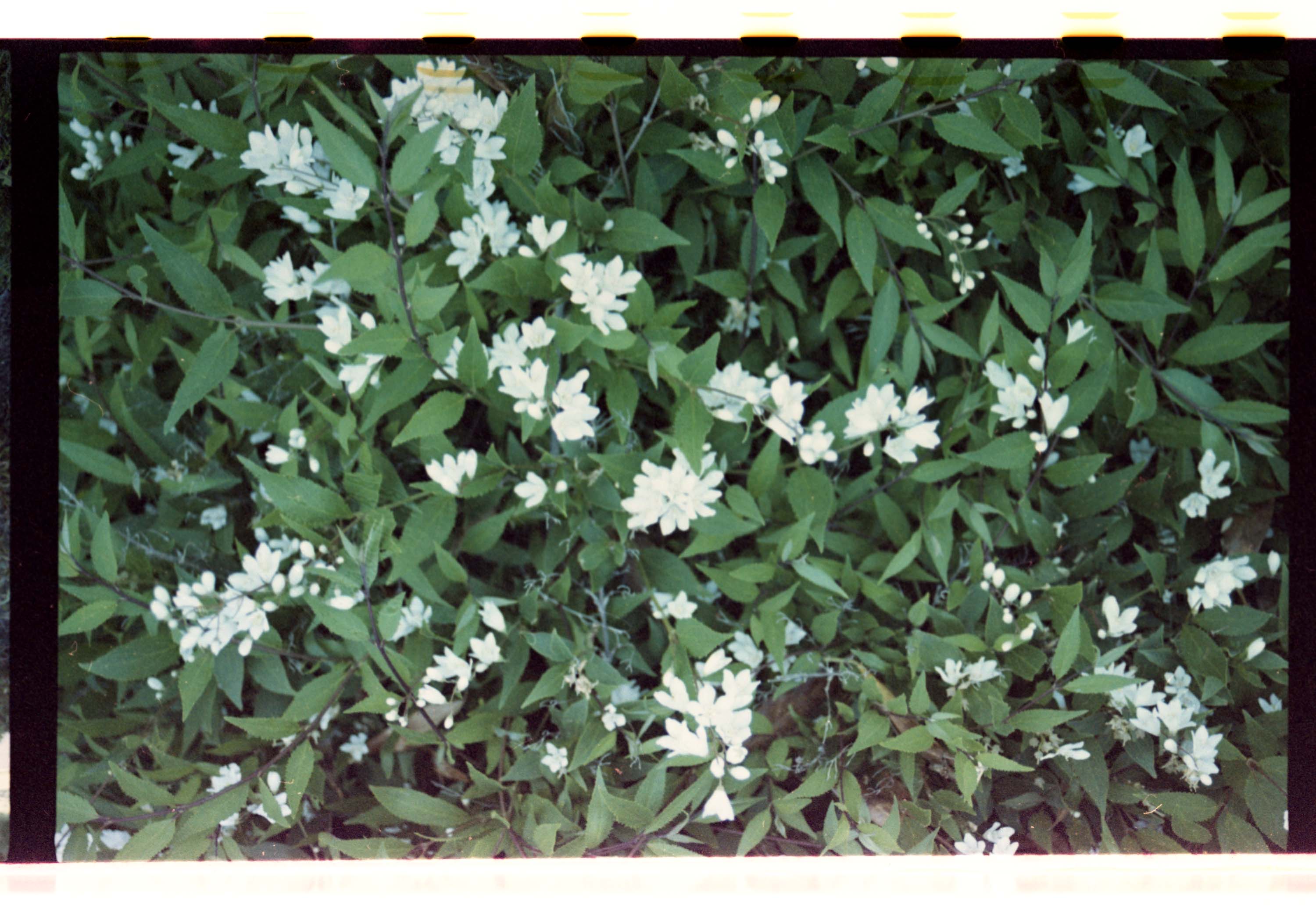

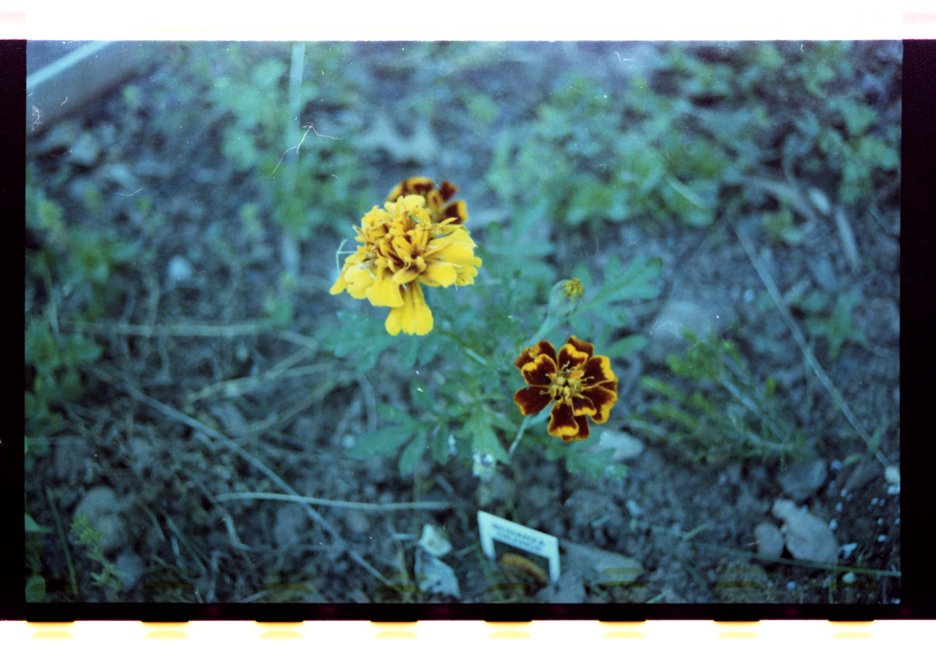

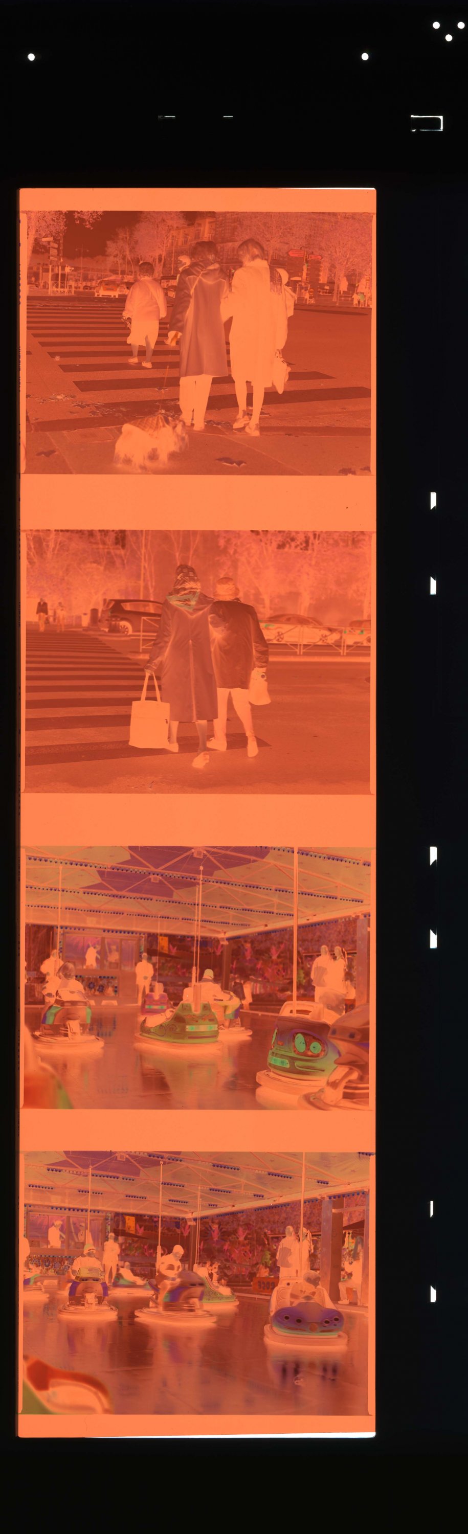

Here I did some testing with C-41 process. The developer is fresh, but the concentrate is several years old. Part C is just very light yellow and smells very strong. Both fixer and bleach were old and was used to process 3 rolls of film before. The tested film was exposed several years ago.
Directly from the scanner, the film strip looks light, or white-looking. After the scanner adjustment, the scan seems ok.
Just try to get some ideas if the chemicals are fine. I'll test with some fresh film.
That suggests the fixer is dead. Try re-fixing the film in fresh fixer, you might get a little better result.
Yes, thanks.
This is what I did yesterday evening. The fixer working solution has quite a bit dark residual at the bottom. Now the film base is clear.

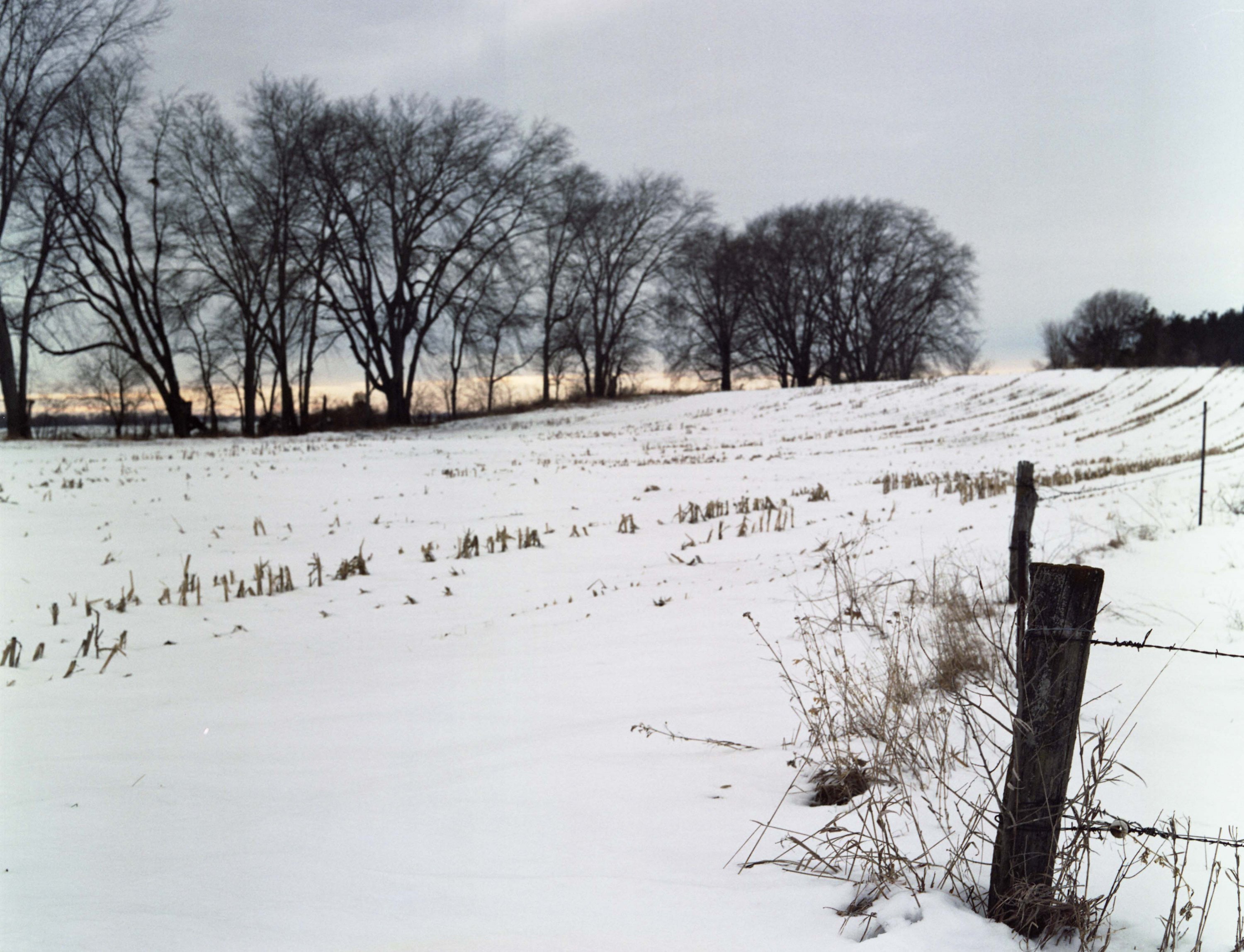

Now the only thing is that, the film has some kind of color tint. Cyan tint? I think that may be scanner tint, not film. Film scan is perfectly fine.
Can we see the film, rather than a scan?
Looking at that little film strip, I'd say your scanner/software is thrown off by the little bit in the lower left corner where there's no film between the lamp and the sensor, which throws the color balance out of whack. In the big scan there is an unevenness of the color balance across the frame (cyan at the edges, magenta in the center) which can be due to a variety of issues in the film itself (age), processing or scanning.
At this point, given what you stated before (using film that was exposed several years ago - is that also true for the medium format example?), we could be looking at any number of things really. I suppose the question gets down to if this is good enough for you as it is, or if you need further improvement. In case of the latter, the obvious first step would obviously be to use fresh film and fresh chemistry (particularly the developer) and then troubleshoot any issues that remain after that intervention.
The MF film is Fuji Pro 160S. It is not old. The actual film looks good to me. The one with the bad fixer is really dark.
Those look normal to me. Your "tint" most likely comes from the software trying to do things but not doing them well.
I googled more about this, and I see a lot of original neg scans are cyan or blue tint color. I guess this is how scanners do it with the strips.
