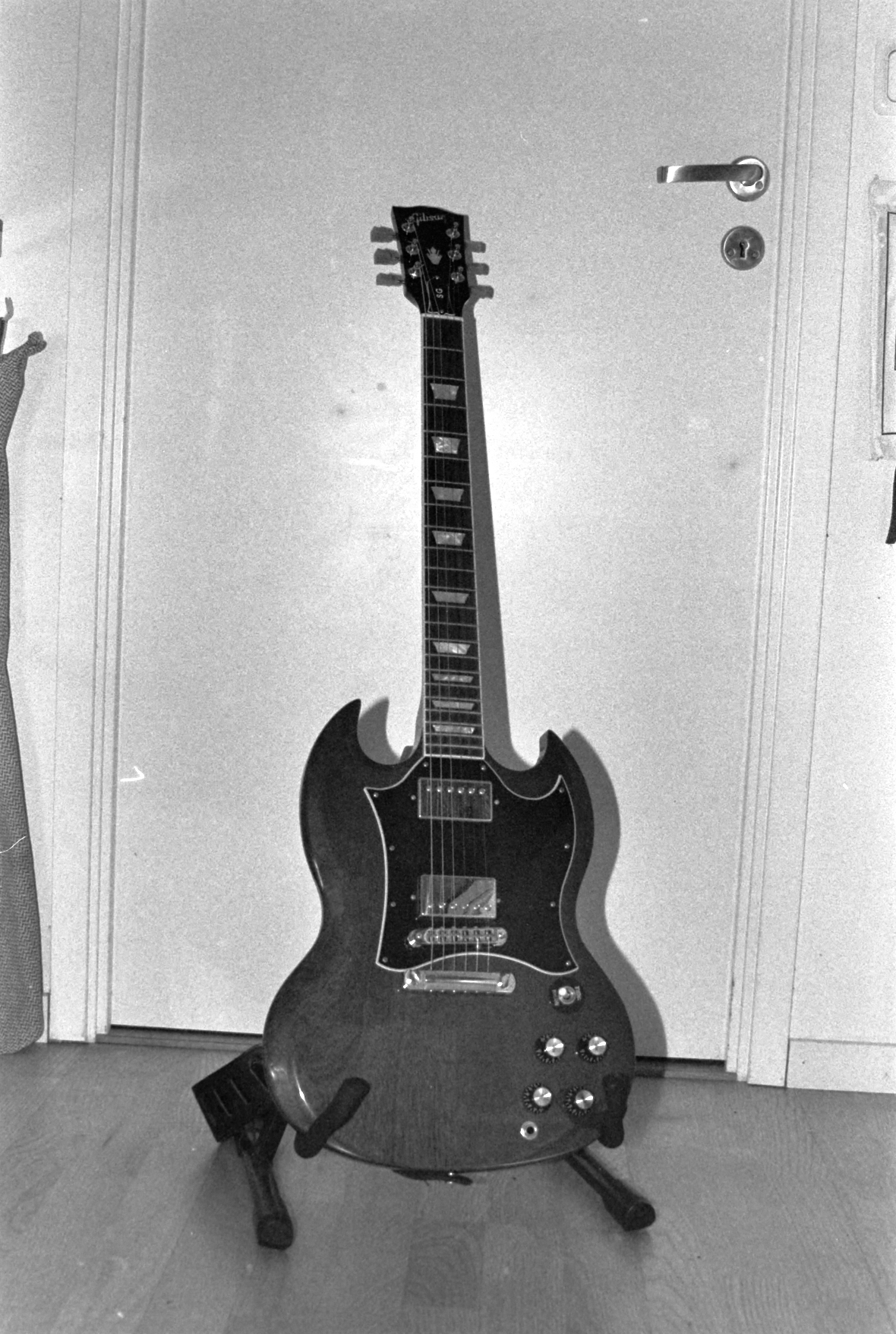

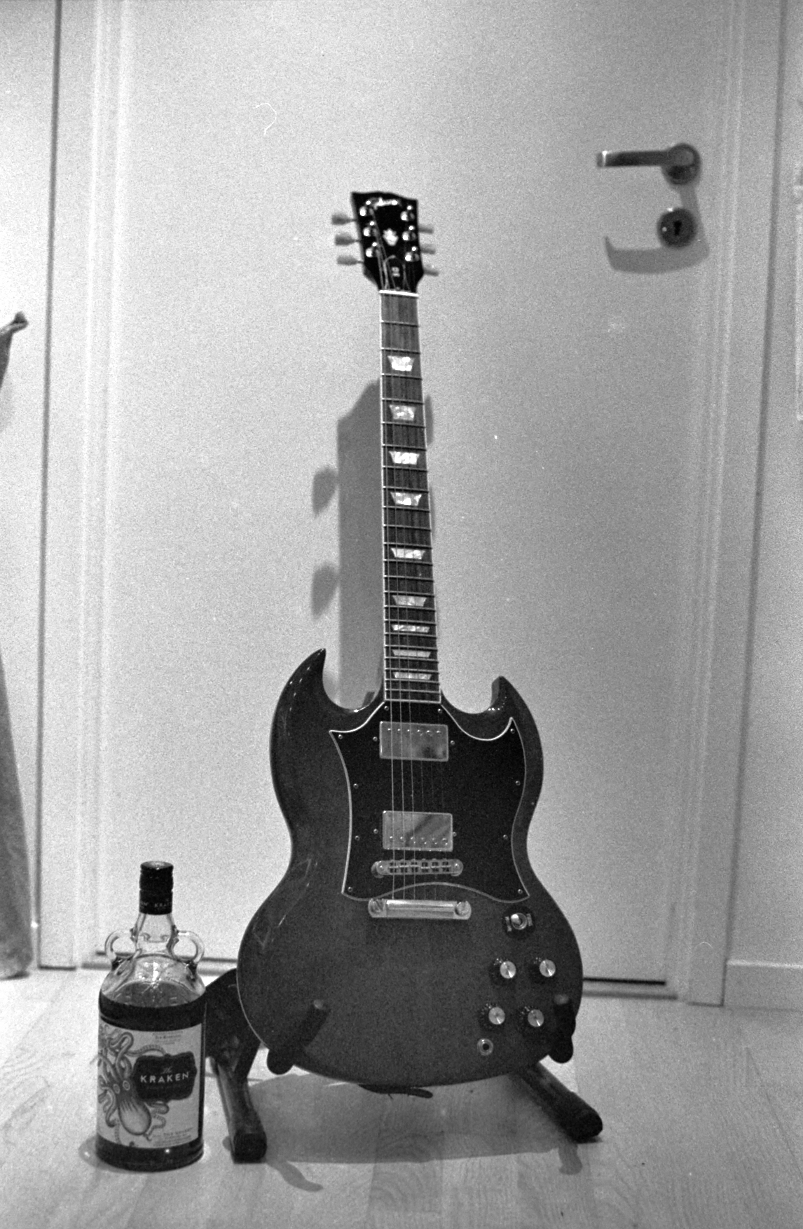

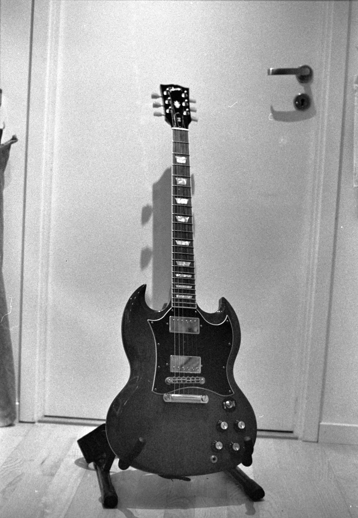

Here they are, shot at night with overhead spotlights to have a controlled and uniform light (no changing daylight). The first one is frame no1, the second one (with the bottle) was snapped 16 frames after frame 1 and the last one was just for fun with a flash, 23 frames after frame one. Then I added one more that was shot on the same location with the exact same light but obviously a different scene. I used the the same film though, approximately 70 frames before frame 1.
I can't see any significant difference between the first three while the last one is much sharper with smoother grain. One - three were obviously developed together while the last one was developed separately. The first three were developed for 4 minutes 30 seconds in Kodak TMax at 21 degrees while the last one was developed in D76 for 5 minutes at 20 degrees.
In this case I'd say the developer probably accounts for the difference.
I have to confess you lost me a little on the whole frame count thing....
It sounds to me like there was not a considerable difference between the film from the outside of the spool and that from the inside. Did I get that right?
Yeah, onlyv16 frames between the ones with identical exposure. 23 frames between the first one and the one with flash. I can't really see any difference either way though.
