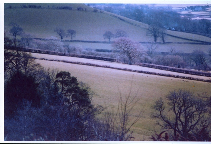

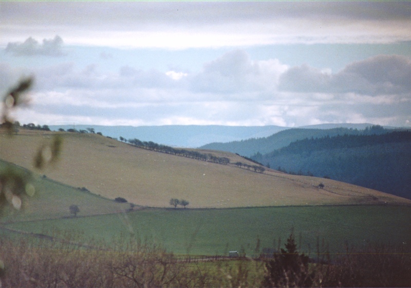

from my film camera both x-700 and pentax p30t
not as good as my now busted 3 mp other format
this is a scan from a print i just run off of a photo taken with x-700
i would of thought that a 35mm would be very nice
but i could be letting my camera down lol
Q.G.
Jul 23, 2007
5,535
Netherlands
That indeed looks terrible.
Hard to say why, but it's probably indeed something you do. :wink:
Seriously, this is not what you should be getting. So unless something is wrong with the camera, lens or film (or all three), it is you, or whoever else processes the stuff such that this is the final result.

sadly i think its me as the film from the pentax is no better
here
jeffreyg
Jun 12, 2008
2,641
florida
Have you used or tried fresh film? Was the film old or exposed to high heat? Have you tried a different processor?
Feb 10, 2010
2,834
Flintstone MD
More details.Filter?Film Type?Clean Glass?The colors appear flat and washed out.And it looks like you may have gotten your finger in the way on the Pentax pic.What altitude were these taken?

First pic looks like camera has light leaks. May require attention. Probably needs new door seals (usually foam rubber in those days)

How big is your print? If it is 4x6 then there are no more than 2MP in the picture. The print also loses a lot of information that is in the negative. It seems also that the first shot was out of focus and was underexposed (although it looks light). Scan from a 4x6 print is never be as good as picture from a 3MP camera.

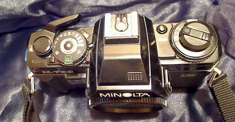

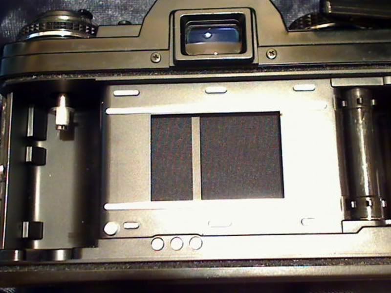

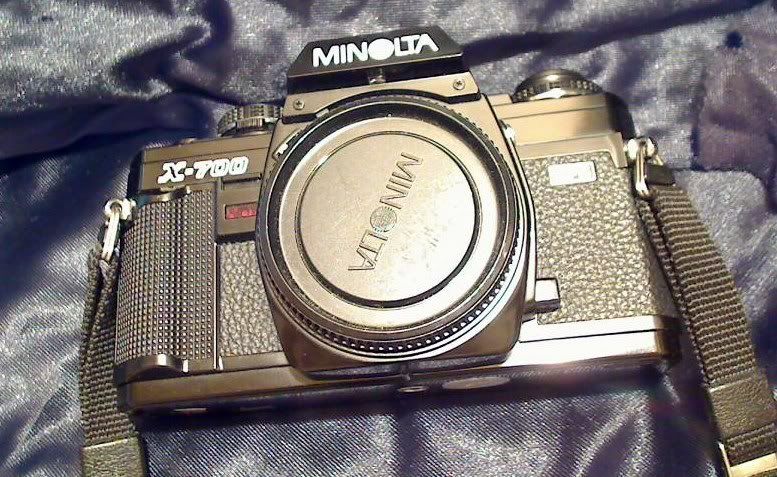

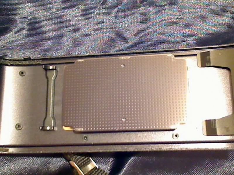

ok here are some pics i shot just now with webcam
wblynch
Feb 9, 2009
1,697
Mission Viejo
127 Format
It appears that there are foam bits stuck to the edges of your film door. That looks like deteriorated light seals. It's very common for any camera over 20 years old.
Try to tape up the edges with some black masking tape for the remainder of this roll and see if it helps.
You can get resealing foam kits on ebay for about 10 or 15 dollars.

great i shot two rolls in that camera still to be developed

Get the negatives optically printed and you'll be surprised the difference it makes. You can also try a film like Ektar 100.
Edit: the camera itself does not influence the quality of the final picture (with the exception of light leaks and scratches.) Only the lens has an effect.

A number possibilities:
1. A lot of mini-labs make lousy prints. Between old chemistry and operators who don't care, the results can be awful. Bring your negatives to another lab and bring one of your bad prints. Ask if they can do better. You may have to shop around to find a lab (and even an individual who works at the lab) who gives a darn. You may have to pay more for quality & experience.
2. A lot of mini-labs make lousy negatives. While it less common to mess up the developing machinery, it's not unheard of. But if you shop around, again you might find a lab who cares. (Scratches and dust are more common problems.)
3. Light leaks as mentioned. This may not affect all exposures equally. The ones that spent the least time in the leak area (e.g. end of the roll where you rewound shortly afterwards) might still be OK.
4. Take more control by developing, printing (or - gasp - scanning) your negatives yourself. If you can't find a lab you can trust, then learn to do it yourself. Details of scanning are off-topic (see hybridphoto.com) but every step you do yourself means you know exactly how well (or poorly) it will be done.

Concentrate on the Pentax, for now. Get a tripod and a cable release. Find out where you can get some fresh Ektachrome 100 or Fuji Provia 100F and get it processed (just developed, not cut and mounted). Quit trying to take landscapes. Take something reasonably close without any sky in it, preferably with lots of detail like a street scene.
I think you have light leaks in the Minolta and, probably, exposure issues. These are aggravated by trying to take pictures that appear to involve a lot of atmospheric haze and exceeding the film's exposure latitude by trying to combine sky and terrain using an averaged meter reading and no compensation.
Your Minolta has a fresnel focusing screen in the center for fine focusing and it should be clear when you are focusing on your subject. It also has a split image which should be aligned to indicate proper focusing. I am not familiar with the Pentax, but, hopefully, it is similar. Use a tripod and a cable release to allow you to focus precisely and not disturb the camera when you release the shutter. Bracket the shots to give the same aperture and three different shutter speeds for each, one at the metered speed, one one stop slower and another one stop faster.
If you cannot use slide film, use black and white. Use C-41 process B&W film if that is all you can get processed, but leave the color negative film alone for now. What you want to do is eliminate as many processing problems as possible and make any such problems as obvious as possible. Slide film is better for this because the exposure latitude is narrower, the color and contrast are not subject to problems in printing and metering errors show up faster. However, trying to take the kinds of photographs you are now with slide film and no compensation will just aggravate your problems.
If you can, get a light meter that reads incident light. If there is a large difference between it and what your camera is reading, use the incident reading to set the aperture and shutter speed manually for the exposure. Last, keep the light behind you--no shooting into the sun.

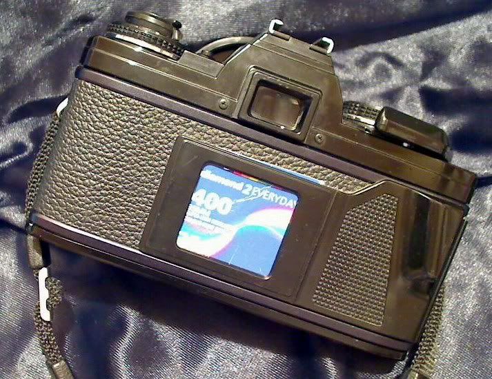

the lcd display o n the back of the camera looks
like you have the camera set to auto and "square image"
try tweeking it to 135, and "full sat noholga", instead of what it is on now
cool image of a film box btw.
cyberspider
Mar 10, 2010
123
aberystwyth
there is no lcd on the back of the camera
and i have no idea what anything else you said means lol
sorry you will have to explain im a beginner
thank you
lxdude
Apr 8, 2009
7,094
Redlands, So
thank you
He's teasing you. The film box end in the slot on the camera back sort of looks like an LCD display, as it's rather light, looking like it's illuminated.
The rest is funny, too. If you can't figure it out, maybe he'll explain it. It's just a little joking around.
:smile::smile::smile:
