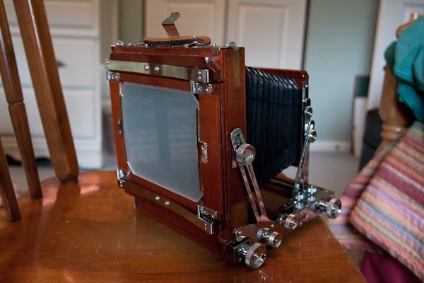

it's an Ikeda Anba 4x5 view camera, really basic stuff. I was looking at some panoramic images last night and thinking, "hey I really want to try that." I think at this point I won't be able to afford any sort of panoramic option but it would certainly seem to be easier to just slap a back on this cam rather than buying a whole new one.
here's the camera

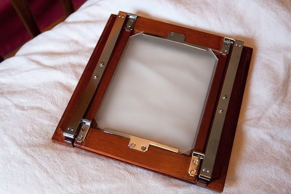

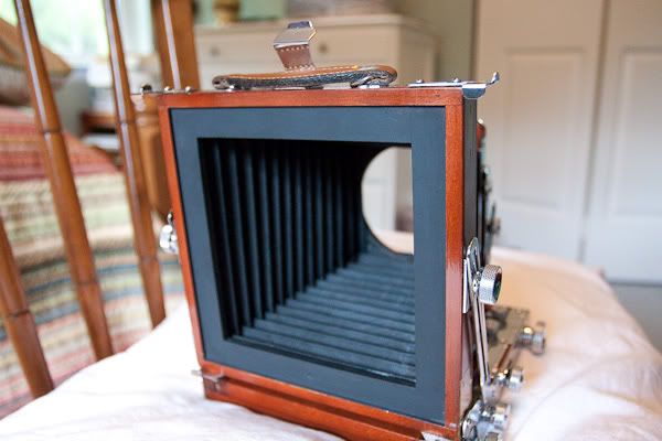

Here's the empty back hole (technical term)
here's the lonely back
I wouldn't think so but one can hope.

to put a roll film back on a camera, usually you remove
just the ground glass, not the whole back as you have done.
does the ground glass come off ( latches ) ?
if so, it is probably like an "international back"
if not, you probably can make a back or buy one
that fits on like the one you removed, with a speed graphic
or graflok ( old name for international back ) and use your roll film adapter.
maybe someone with the same camera can give you a better answer ...

It looks like a regular spring back, as opposed to a Graflok/International type back, so as the others have said, you would need the type of rollfilm back that slips under the groundglass like a regular filmholder. There are some less costly ones made by Calumet, and fancier ones made by Sinar (Zoom, Zoom II, Vario I think, and a few others) and Linhof (Rapid Rollex--not easy to find used, and very expensive new). The Sinar Zoom backs are multi-format.

the glass is sadly, not removable.
As I suspected. Thanks again!

Your back doesn't have the Graflok retaining clips, so you need a slide-in type rollholder.
Sinar (Panorama, Vario, Zoom, Zoom2) and Calumet/Cambo (C2N) have made slide-in backs in 6x12 format. They're quite big and heavy, and you may find that the rear standard of an ultralight camera like the Ikeda flexes a bit under the weight.
The Sinar ones were frightfully expensive - the last new price was in the thousands of dollars - but now can occasionally be found used for a semi-reasonable price. The Calumet/Cambo is still listed new at $869.99.
