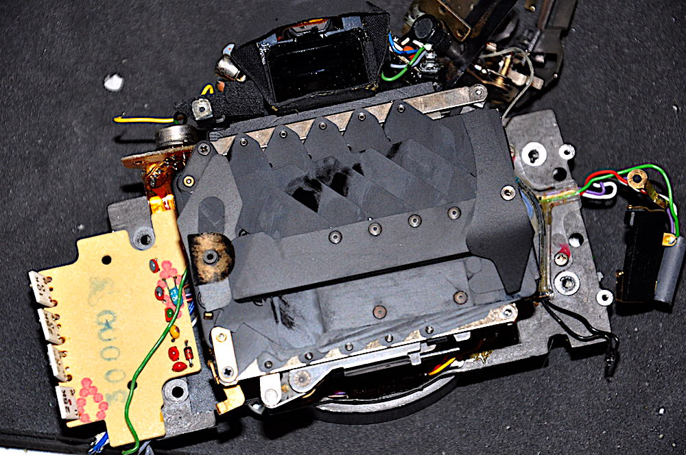

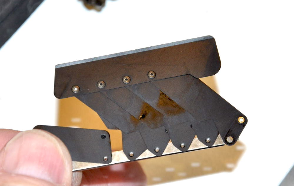

The oil will seep back on the blades. The whole shutter assembly needs to be either disassembled to its individual blades, or the whole blade assembly soaked in solvent.
On this camera, it took about 4 hours work to get to the shutter. That included unsoldering about 20 wires.
It was nice to get this one working again. If froze up in 1994 in a Minnesota winter taking pictures of geese.
