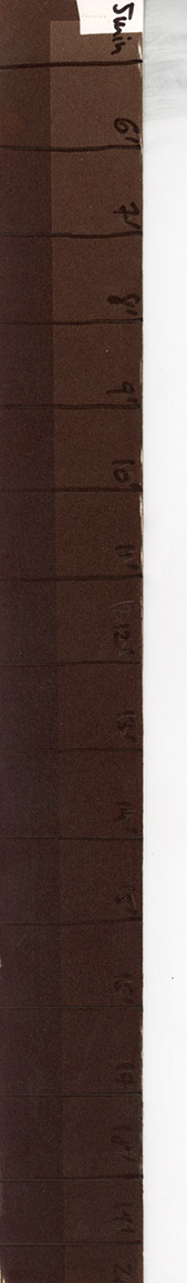

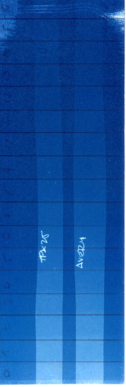

With several brands of OHP transparencies (pictorico, novalith, ...), and with several alternative processes (cyanotype, kallitype, van dyke brown, ...), I never manage to reach the same Dmax after exposure in my contact printing frame as with the same sensitized paper but without a transparency / negative.
You can see this with the 2 attached test strips (one for the cyanotype process, the other for the van dyke brown process) : I cannot reach the maximum Dmax with the OHP transparency, or I guess it would take an infinitely long exposure time...

Have you ever encountered the same problem? Should I try other brands of transparencies? I've mainly tested Pictorico OHP (+ premium) and also Novalith TPX25... Is it related to the thickness and/or opacity of the transparency? Or my UV source? Or a combination of both?
