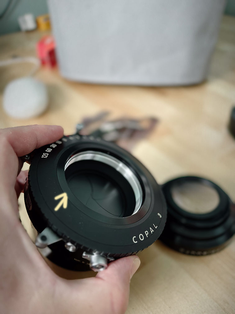

I ordered a lovely Copal 3 shutter all the way from Japan. This is a REAL Copal 3 and not 3S. The rear element fits...but the front doesn't seem to reach the threading!!!!
Does this little black ring screw off to maybe allow for the threads to travel a little deeper into the shutter to reach the threads?

On compur 0 shutters there is a plastic ring that pops out( vanity ring)
This looks like that but I can't say 100% about a 3

I slipped a flathead in there and instead of trying to pry, I just rotated the screw driver, popped right out. The front element is now sitting pretty on the shutter.
