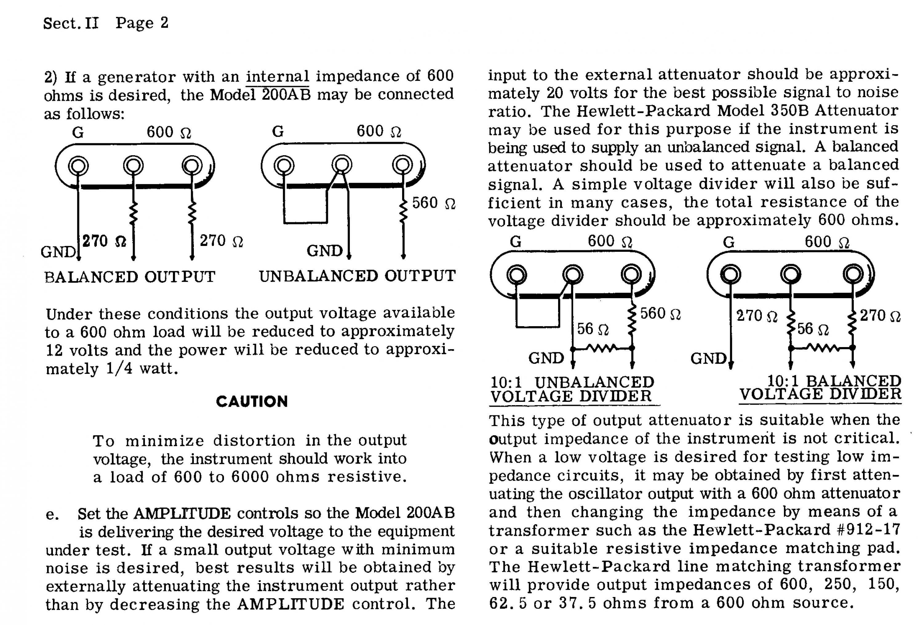

Thank you for allowing this post to remain. I have a technical question related to electronics and post it here because I think I know of a few folks who can answer me most correctly (insert my respect here). I would like to ask anyone who knows how to draw me up a little circuit to divide the signal from an HP 200 ABR into stereo so that I can run the signal into the inputs of tape recorders to align their circuits and heads. Typically, the line in would be 0db or .775 volts. But I do not know what kind of little resistor/capacitor arrangement I would need to fabricate. The HP ABR has a 600Ω output. I am providing a page from the manual. Thank you.The power output as listed in the HP 200 ABR manual is 1 watt or 24.5 V into a 600 ohm load

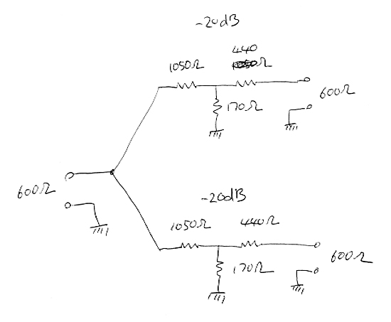

Hi,
If the source (your signal generator) can generate that much power, then I'd use something like 1:100 attenuator for 600 ohm unbalanced for L and R channels and tie the input side together. Attenuators will provide the necessary isolation as well as reducing the massive power into your equipment.
There is no need for capacitors as there is no DC components to block out.

Thank you but I wouldn't know how to draw up such a schematic. I'm capable of reading schematics but not designing them.

This is what I would do....
Each attenuator has an input impedance of 1200 ohm, output impedance of 600 ohm, and loss of -20db.
Since the input is in parallel, it will match the 600 ohm impedance of the source.
I found an online calculator for the resistor values.

Oh, by the way, I would suggest using metal film type resistor. (see, it's FILM related!)

Thanks friend. I'll whip up one of those that you just designed. Of course I'll have to go toRadio Shack, which doesn't sell electronics any more, and get the closest values I can and depend on the output control on the HP get my .775. I just didn't know how to split the signal and get all the impedences right. I knew the HP would overpower my tape recorder straight off the HP outputs. Looks like with your help I can move on to using this HP instead of generating my signals in Adobe Audition and taking my signals off the sound card. I still need to do some tests and make sure the HP is still putting out flat from 20-20,000. It might not. But if I can get it to generate my signals, I'll be happy. Still looking for a Leader LMV 181a or 185. Using a digital multimeter to calibrate my scope for converting db's to millivolts is a real pain. Thank you sincerely, again.--HTF
