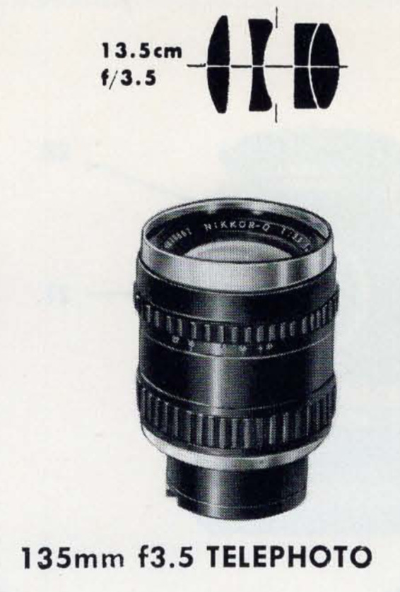

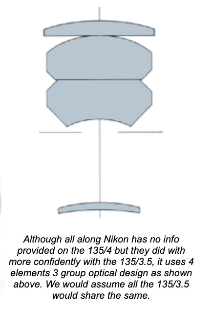

There was also a Nikkor-Q 135/3.5 for the Bronica S, S2, etc. This lens is clearly a 4-element Tessar from the lens diagram, second figure below which I've reproduced below from some Bronica S literature. This makes sense for covering 6x6, because the Tessar-based design usually has somewhat more coverage than a Sonnar design at the same focal length. That's one reason we typically see Sonnars used for short-ish telephotos and the occasional 50mm rangefinder lens on 35mm (probably not good for a 50mm SLR lens due to mirror clearance).
So, I don't think the design was re-used, unless there is some earlier 135mm for Bronica that I don't know about. I also have had both of these 135/3.5 lenses (they are easy to find) and IIRC the glass elements and reflections are clearly different. That said, if you could dismount the rangefinder 135 mm lens head from the mount and hold it in front of a 645 camera, it might cover the format at least adequately for portraits. Covering 6x4.5 (about 70mm diagonal) is not a huge ask for a 135mm lens.
Rangefinder lens, above.
Bronica S 6x6 lens, above.
