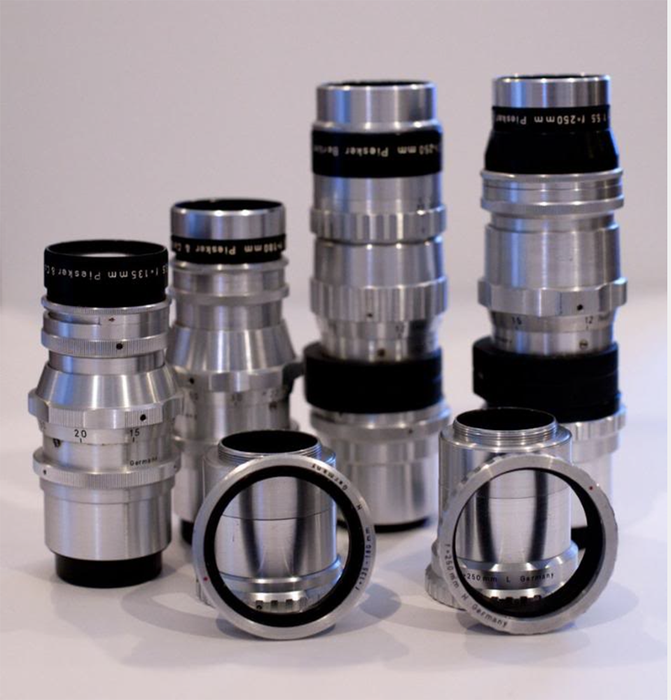

Here are a few vintage (1950s ?) lenses mfg by Piesker in Germany. These must also have been re-badged for other brands such as Tele-Votar, etc, which look similar, but these have an interesting mount system. I have picked up a few over the years, all Tele-Picons 135mm f/3.5, 180mm f/5.5, (2) 250mm f/5.5. All except one of the 250mm lenses have pre-set diaphragms. The other 250 has a totally manual aperture. There are many interesting oddities about these heavy, chrome beasts. Three of the lenses are marked Piesker & Co. Berlin, the fourth carries the designation Piesker Berlin West-Germany. The chrome is heavy on all the examples and the glass and mechanics have withstood the test of time.
More to the point of this thread, as you can see in the photo of all four lenses, they come with interchangable mounts - like an early T-mount system. There are two varieties of mounts: 1 set for focal lengths between135 and 180mm and 1 set for the 250mm. The mounts I have include: Exakta classic bayonet, M42, Leica screw, and Hasselblad screw. Because they could be mounted to a Hassy (early 1000F or 1600F), they must be able to cover 6x6.
Here is a pic of all the lenses with a few of the different mounts. The Hasselblad mounts, labelled "H" are the two large rings in the front.

Wow, thank you for reminding me about these Piesker lenses. You just jogged me into remembering that I have that 135/3.5 in my collection with the H mount. I forgot I had it and have never used it. I need to do something about that.
