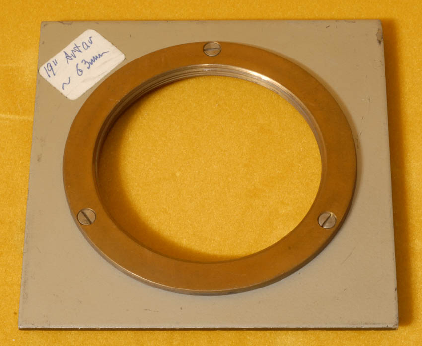

I believe what you have is a lens mounted on a board to fit a photographic printer. I have several of them with L39 threads to fit enlarging lenses. As the photo shows, they fit a brass mount with flanges that fits into the printer. The diameter of the threads is around 65mm.
