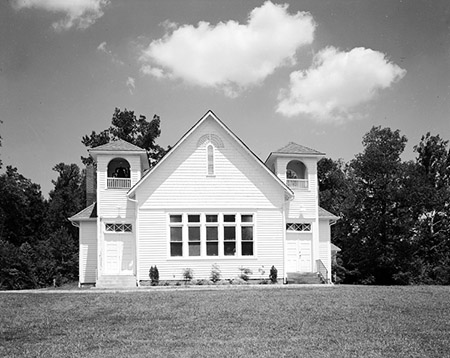

And, you often have great difficulty printing stained negatives using alternative processes or Azo paper due to the UV vs visible absorption of stained negatives.PE
I think Edward Weston would probably disagree and has a body of work developed in pyro and printed on silver chloride paper... I've printed many, many, negatives on Azo very well that were developed in pyro.
As far as losing information, I wouldn't call it that. What I've lost at this point is the contrast mask, all the silver is still there. And I can supposedly (according to Hutchings) regenerate at least part of the stain. He notes that you can remove and restore the stain several times and the negative will reach a point where the final stain is somewhat less than a freshly developed negative.
Cheers, Steve

I see no comparison in that print to show me what is going on.
But, I must say that those that print using UV radiation, those that use UV + visible and those that use visible will see differences with stained negative in side by side comparisons.
I object to single examples of this vs that. You cannot do a comparison without both.
Sorry.
PE

Sure pyro stained negatives print differently when there's a UV component to the light, that's the point as Ian writes. The result is more in highlights, like detail in the clouds in the attached image above. Those clouds were difficult; very bright and little detail in actuality standing there looking at them. I would have liked more but that isn't what I had. Pyro (compensating developer) helped preserve what details there were in the clouds and help keep them from becoming paper-white cutouts. I still held them back as much as possible in printing, which I did not do in the scan BTW.
